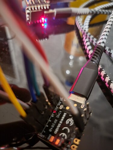

Hallo, with an XIAO RP2040 and MCP2515 maybe for i think 100 hours all possible to get it work - i become no messages from the Audi A3 8p 2006.
Connections:
Xiao RP2040 MCP2515
D10 MOSI MOSI
D9 MISO MISO
D8 SCK SCK
D7 CSn CS
D1 INT
I tryed this:
I tryed 3 different MCP2515, an ESP32, another Oscilator from 8MHz to 16 MHz,
network termination on the MCP2515 i bridged.
I used this code (and also other i tryed):

I tryed to write the Pins with an "D" and without. For example D1 for INT.
The Can Speed on this car is 500Kbit on the PINS of the OBD: 3 + 11
No Idea what else i can try and where is here the issue. I am a "Beginner" but so stupid i think i am also not.
I Hope you can help me. I can later put some pictures from all this here into.
