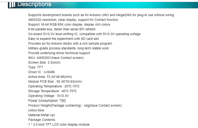

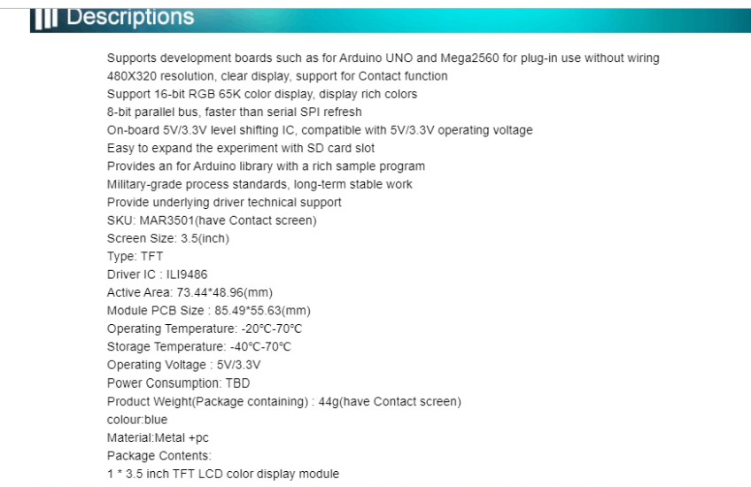

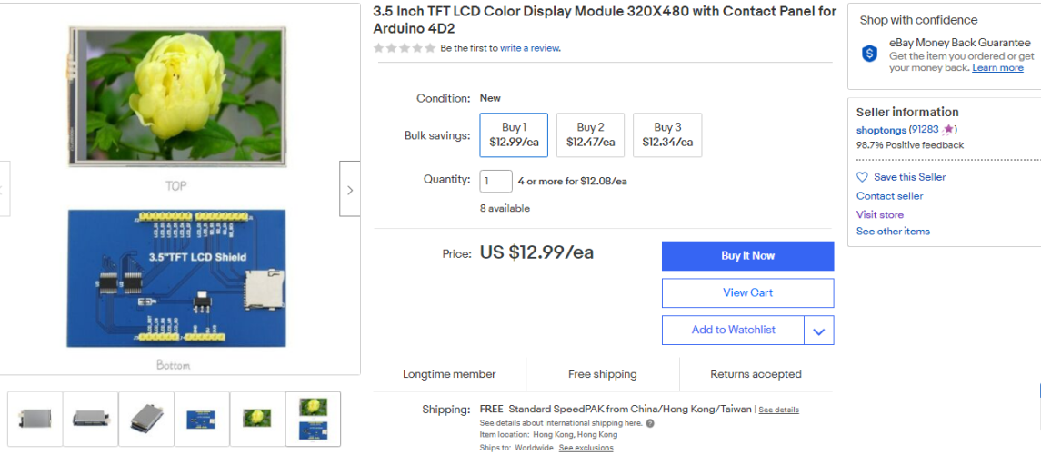

thank you for your quick and thorough reply. it has been a little hectic around here. as for the ebay pages :
the first, and working display : ebay has stopped the link to my purchase item number (it was about 4 months ago), so i can only say that yes, it has the band around it leading to a 4 wire cable, and i can send a copy of the image of it that i made when i bought it. attached.
the second (and non-working display) : https://www.ebay.com/itm/US-3-5-Inch-TFT-Screen-Module-480-x-320-For-Arduino-UNO-MEGA-2560-R3-Board/202798422049?ssPageName=STRK%3AMEBIDX%3AIT&_trksid=p2057872.m2749.l2649
this second display does NOT have the gold/silver banding.
about a week ago i ordered 2 more displays : the first is one that has the same banding :
https://www.ebay.com/itm/3-5-Inch-Screen-LCD-Display-HDMI-Interface-TFT-Monitor-Module-N9G9/163957330556?ssPageName=STRK%3AMEBIDX%3AIT&_trksid=p2057872.m2749.l2649
and as nearly as i can tell, an exact match for the working display.
the second does not have the banding :
I will wait until they come in to see if the non-resistive screen is the problem.
if the banded one works, then i will just get more of them, rather than try using a new library etc. for a different type of screen. if it doesn't, damn the bad luck.
The first Ebay link says:
  1. Compatible with UTFT / UTFT_Buttons / Utouch Library.
which implies a Touch panel. However it certainly is NOT Utouch compatible.
the photo shows a Touch Panel. But quite honestly I would not trust an Ebay description until the item arrives. And you can compare the item on your desk with the photos, information, ... on the Ebay sale page.
