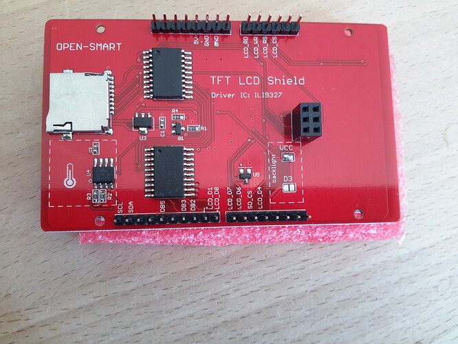

Hey David,
I recently bought a 3.5" LCD screen from eBay for use with a STM32, but since it is a Uno form-factor shield, I want to get it working on an Uno first.
The seller claims that it is a ILI9488 @ 480x320, but it doesn't seem to be giving the correct ID, or working out of the box with mcufriend_kbv. Instead, the graphics test appears to be working in a smaller area of the screen... more like a 240x320 area. Am I doing something wrong, or have I been sold a lemon? I'm using the 'normal' mcufriend_kbv library (v2.9.4), with adafruit_gfx v1.1.9 and Arduino IDE v1.8.1, and running the graphicstest_kbv. Please let me know if you want any more info or pictures.

@nickanor,
Run the diagnose_touchpins sketch to identify which pins are X and Y. (in portrait)
If the X direction is wong, exchange the LEFT and RIGHT calibration values.
@pfeerick,
Many Ebay vendors supply the same useless information.
Does the pcb look like the photos?
Does it have a paper sticky label?
It is certainly NOT an ILI9488. The link shows an initialisation for an ILI9327. It is not an ILI9327.
I don't recognise any of the usual places where an ID might be stored.
Please enable the for loop in the LCD_ID_readreg sketch. This will test every register. If you find some response, post it here.
Ebay Vendors seldom know what they are selling. But it is always worth asking them.
David.
About the only similarity between the board I received (as pictured in the prior message) is the uno form factor and that it is red.
No paper label, and mcufriend decal in a different place.
Here is the (slightly trimmed) extended register dump - doesn't look very promising :-/ Have to post in two parts as exceeds 9000 character post limit...

Dear David,
I purchased 3.95inch TFT LCD for Arduino MEGA from mcufriend. Unfortunately I could not initialize LCD properly.
Attached image for your reference.
However I run read register sketch and provided results here.

Go on. Your attached PNG shows a 3.6" Shield for a mega2560
The LCD_ID_readreg sketch is for:
Read Registers on MCUFRIEND [color=red]UNO[/color] shield
Please post a genuine photo. Or at least count the number of resistor-packs.
The 3.6" photo shows RP1-RP7 which implies a 16-bit interface.
David.
