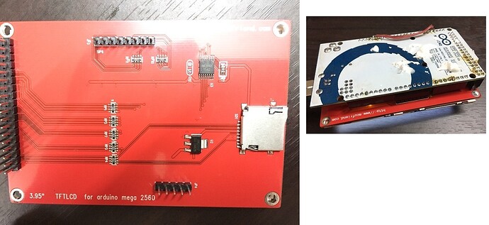

Dear David,
Sorry,
I was in hurry, so not checked image.
Please find the genuine image here,
  1. I checked resister packs, its 5 resistors.
    attached image of lcd back side.
  2. I understand read register sketch is only for UNO shield.
Is there any way to initialize this LCD ?
Please share your valuable suggession.
Thank you.
The 5 resistor packs look like 8-bit write-only interface.
Define USE_SPECIAL and USE_MEGA_8BIT_SHIELD and force begin(0x9488)
Try all the other 320x480 IDs to see which works best.
David.
