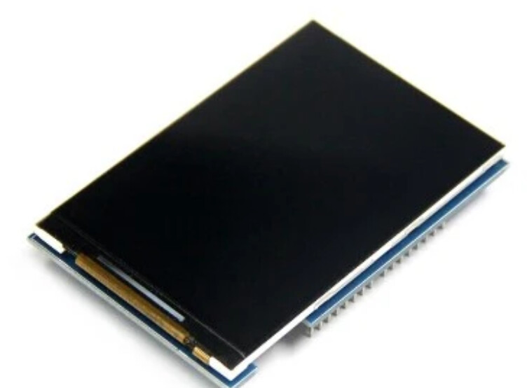

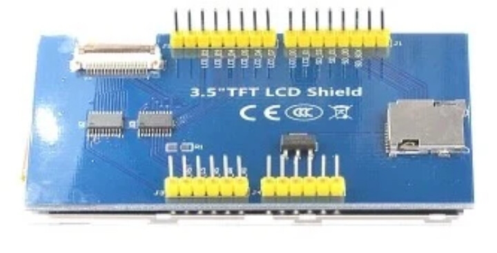

Nobody knows which display you try to use. Please post a link, ot a picture of the backside.
Thank you for your replies. i am using this tft lcd.

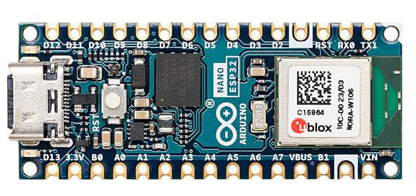

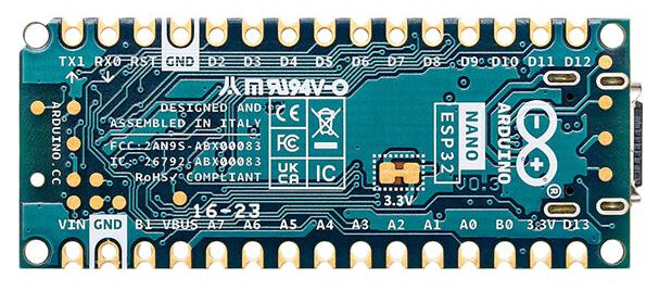

This is the new esp32 nano board.
ABX00092 Arduino | Development Boards, Kits, Programmers | DigiKey

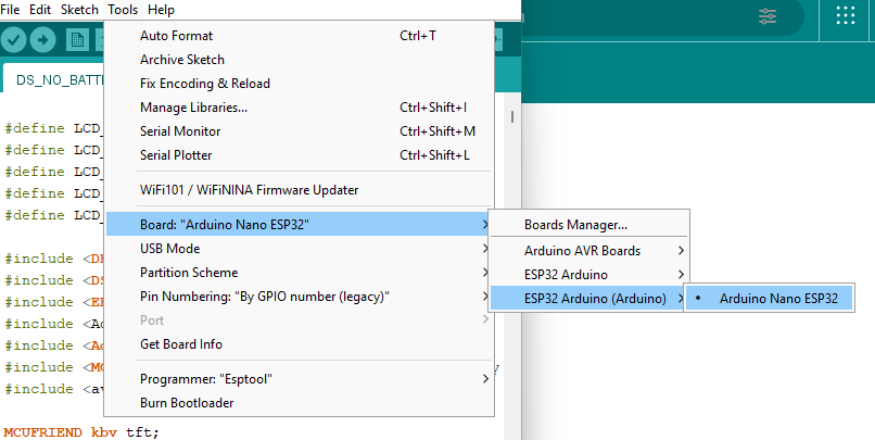

i am using this to upload the code.
I tried to select the "Pin numbering: By GPIO number (legacy)" and it was working with the mcp23017 and dht22 libraries. Now only the tft lcd is not working when using the mcufriend_kvb library.
All the libraries i used are working with the old arduino nano.
