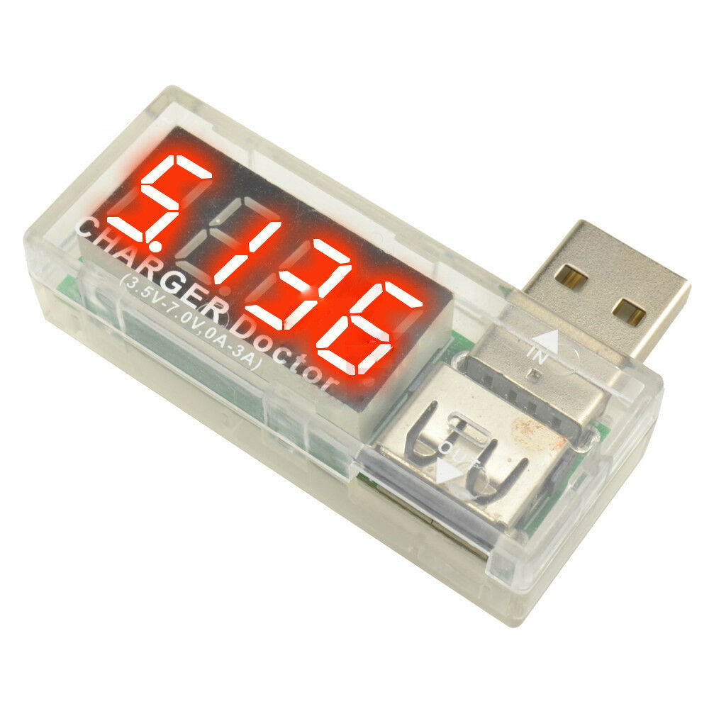

For testing current, these are convenient.

Thanks for the tips on controlling and measuring USB power.
