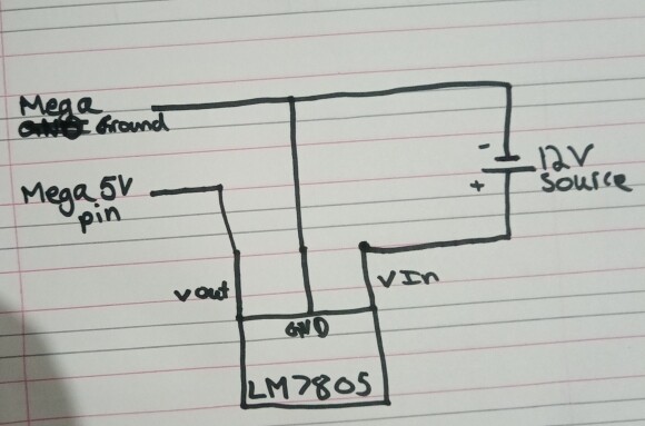

If i use the LM7805 and provide 5v to the pin
Would it be fine? (Attaching pic below)
I am just worried about voltage spikes with this regulator...
Can you post a circuit diagram showing how you would use the LM7805 with the Mega please?
Hand drawn and photographed circuit is perfectly acceptable.
You can use the LM7805 to provide 5V to the 5V pin of the Mega, BUT you will possibly need a heatsink on it and the appropriate bypass capacitors.
The heatsink is because it is a linear regulator like in the Mega that is over heating, and although the LM7805 may not get as hot, it still needs to dissipate the same amount of energy as the Mega regulator did.
IMG_20220625_200526_1
Sorry for my terrible and handwriting and the crude drawing

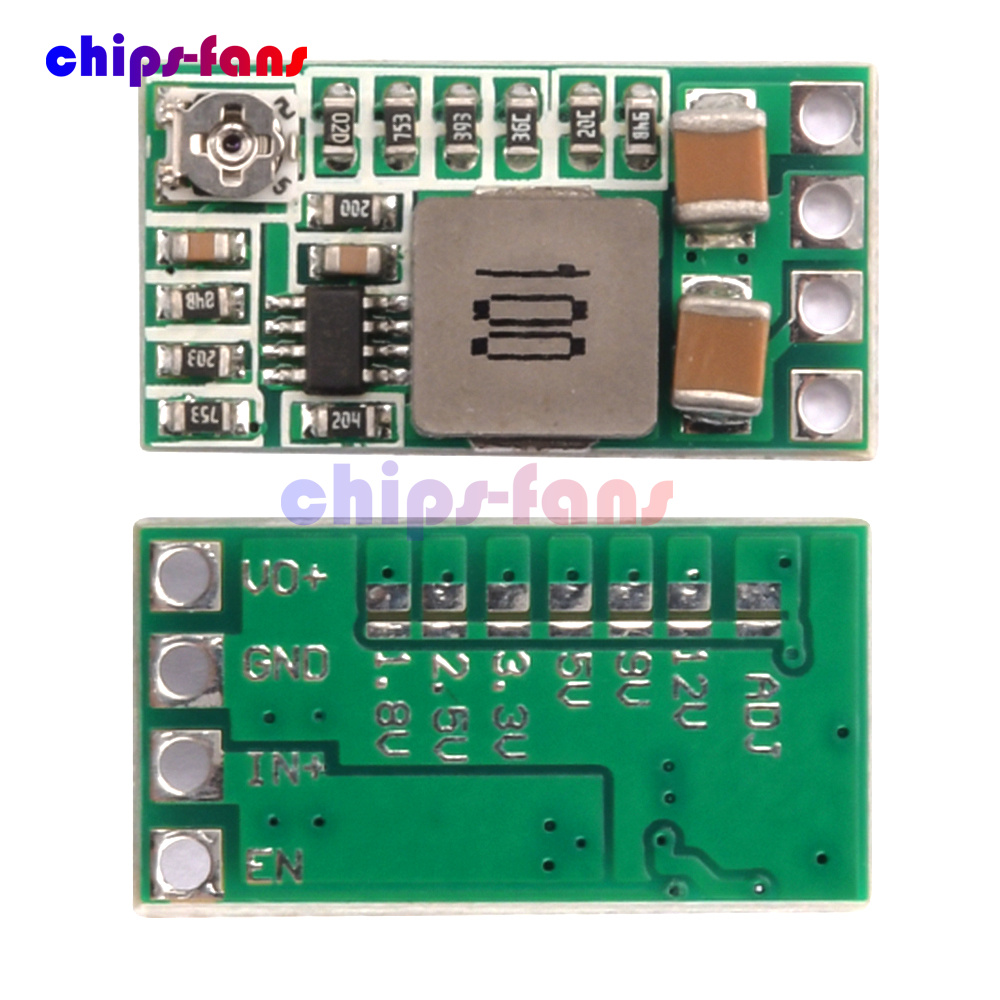

Alright so here's what i plan to do now
Attach a buck/boost converter to the output of the battery and set it at 5Volts output
Plug in output from converter to mega's 5V pin
Attaching pic of buck/boost converter below
Any improvement i should make?
