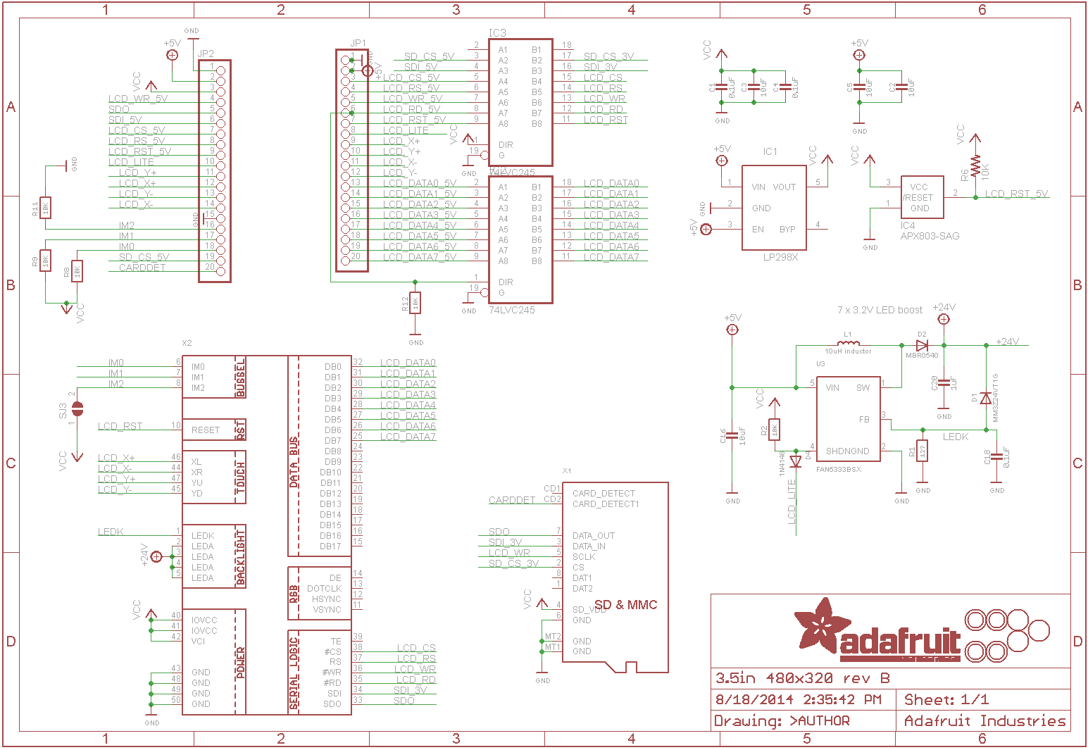

I am currently making a project with an adafruit 3.5" display and a mega2560. I cannot, however, get the SD Card and display to function simultaneously. These are what examples I have been testing with:
SD: CardInfo -- OK
Adafruit TFTLCD Library: Graphicstest -- OK
Adafruit TFTLCD Library: tftbmp -- SD Card Init Failed
In all the examples I have made sure to use pin 53 for the SD card Chip select.
This is a screenshot of the schematic I am using for the PCB.
Note: all example testing was done with only the lcd and SD card connected and powered of an external 5V supply.
I guess that proves there is nothing wrong with the SD or its installation, it might be time to post your code.

Which exact display?
The full name is 3.5" TFT 320x480 + Touchscreen Breakout Board w/MicroSD Socket - HXD8357D
Here is a link Tft lcd
Are you talking about the SD card reader on the display PCB, or a separate SD card reader module?
There have been problems with circuits using multiple SD card readers before because some models contain 5V to 3.3V level shifter circuits which put a constant signal on the MISO connector, preventing other SPI devices from sharing the bus.
It is only the built in SD card reader with the display. There will be thermocouples on the SPI bus in the future but they were disconnected for testing. This is the schematic for the display if you can see any problems with my wiring.
I don't know if this will help but a routine command in Setup for Mega with SD is
  // make sure that the default chip select pin 53 is set to
  // output, even if you don't use it:
  pinMode(53, OUTPUT);//MEGA
Maybe you had that in the Cardinfo test.
I did not add anything to the cardInfo example other than changing the chip select pin. This is the exact code that I used which worked.
