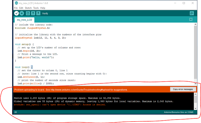

Memory error
Help meee... how to fix this error ?
First of all the issue has nothing to do with memory, it's a serial port problem. The issue is most likely caused by a bug in Arduino IDE1.6.8. Try using another version. Either 1.6.5 or 1.6.9 then let me know if you still can't upload to your Arduino.
Thank You Very Much !! it's really work. i'm update 1.6.9
