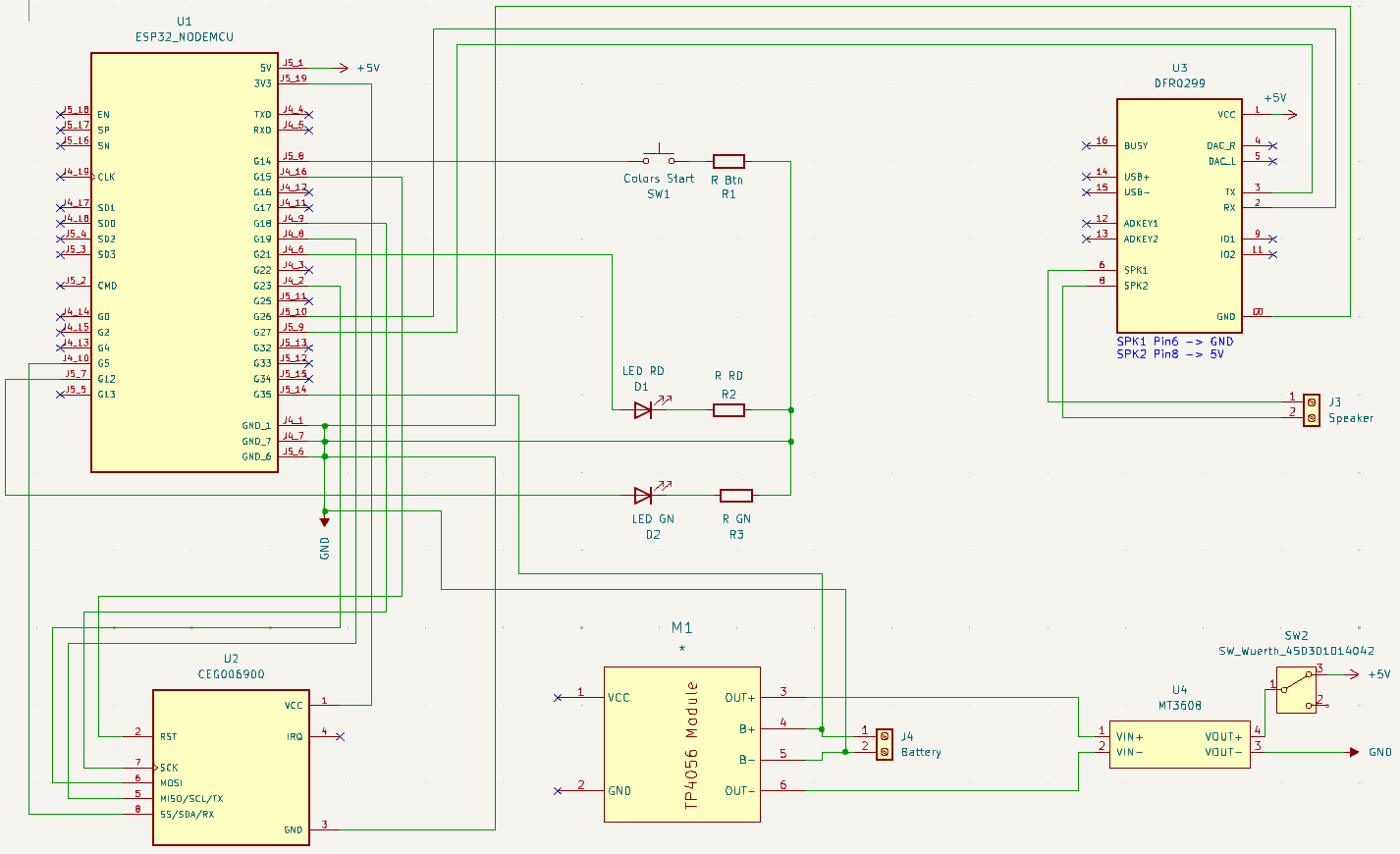

Trying to make small project with RFID, DFPlayer and WIFI AP.
My problem is, if I reconect my ESP32-WROOM-32 to the USB, then after not always my DFPlayer works. I need to RST or again and again reconnect.
Connections:
RFID
SDA -> G5
SCK -> G18
MOSI -> G23
MISO -> G19
GND -> GND (separate)
RST -> G15
3.3V -> 3.3V
DFPlayer
VCC -> 5V
RX -> G26
TX -> G27
SPK1 -> SPK -
SPK2 -> SPK +

Serial.println(wrong);
digitalWrite(LED1, HIGH);
if (wrong == 3){
// player.volume(30);
// player.play(7);
delay(2000);
digitalWrite(LED1, LOW);
playf();
wrong = 0;
else{
player.volume(volume);
player.play(3);
delay(2000);
Sometimes in Serial Monitor i became like this:
After RST button i also became this message:
18:06:00.072 -> T�� Meditation Error: Core 1 panic'ed (LoadProhibited). Exception was unhandled.
18:06:00.137 ->
18:06:00.169 -> Core 1 register dump:
18:06:00.169 -> PC : 0x40175c4d PS @@ : 0x00060a30 A0 : 0x3ff65000 A1 : 0x3ffb2070
18:06:00.266 -> A2 : 0x00000000 A3 : 0x00000000 A4 : 0x00000005 Guru Meditation Error: Core 0 panic'ed (Unhandled debug exception).
18:06:00.425 -> Debug exception reason: BREAK instr
18:06:00.457 -> Core 0 register dump:
18:06:00.490 -> PC : 0x4008501c PS : 0x00000016 A0 : 0x40080306 A1 : 0x3ffbbd50
18:06:00.586 -> A2 : 0x3ffaead4 A3 : 0xffffffff A4 : 0x00060d20 A5 : 0x00060d23
18:06:00.682 -> A6 : 0x3ffb6340 A7 : 0x0000cdcd A8 : 0x8008dc06 A9 : 0x00000001
18:06:00.747 -> A10 : 0x00000001 A11 : 0x0000008e A12 : 0xb33fffff A13 : 0x3f414a7c
18:06:00.842 -> A14 : 0x00000003 A15 : 0x0000cdcd SAR : 0x0000001d EXCCAUSE: 0x00000001
18:06:00.938 -> EXCVADDR: 0x00000000 LBEG : 0x40084639 LEND : 0x40084641 LCOUNT : 0x00000027
18:06:01.034 ->
18:06:01.034 ->
18:06:01.034 -> Backtrace: 0x40085019:0x3ffbbd50 0x40080303:0x3ffbbd80 0x4011be2e:0x3ffbbdc0 0x40086b69:0x3ffbbde0 0x4014a9d4:0x3ffbbe10 0x4013b539:0x3ffbbe30 0x4012712a:0x3ffbbe50 0x4008daa6:0x3ffbbe80
18:06:01.258 ->
18:06:01.258 ->
18:06:01.258 -> Core 1 register dump:
18:06:01.258 -> PC : 0x400e4461 PS : 0x00060334 A0 �Connecting to DFPlayer Mini failed!
18:06:02.207 -> HTTP server started
18:06:02.207 -> mDNS responder started
Could you help me to understand what it could be?
Thank you in advance
Regards
Taras
