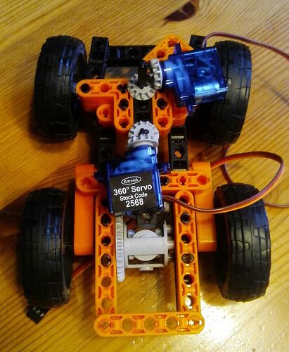

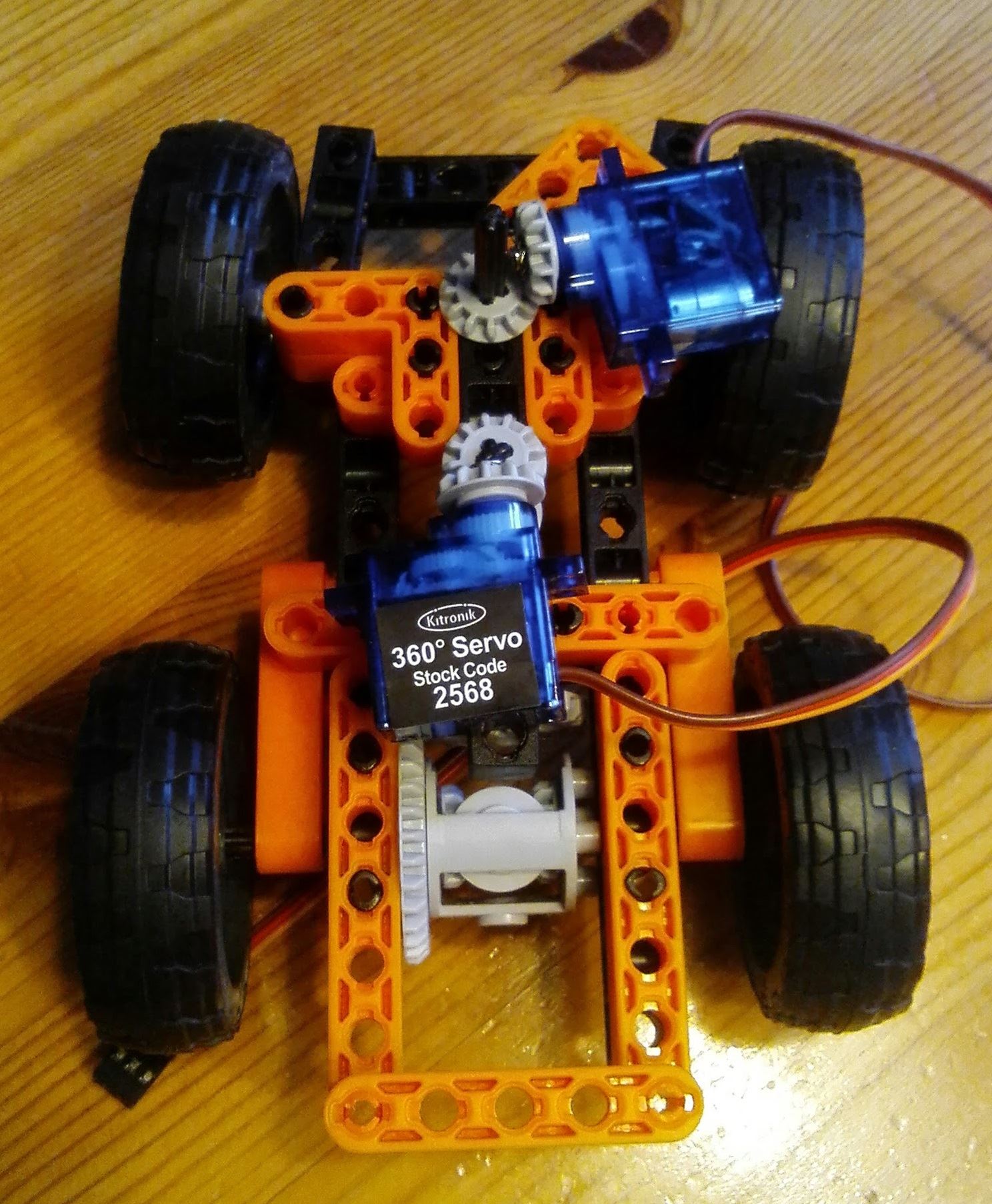

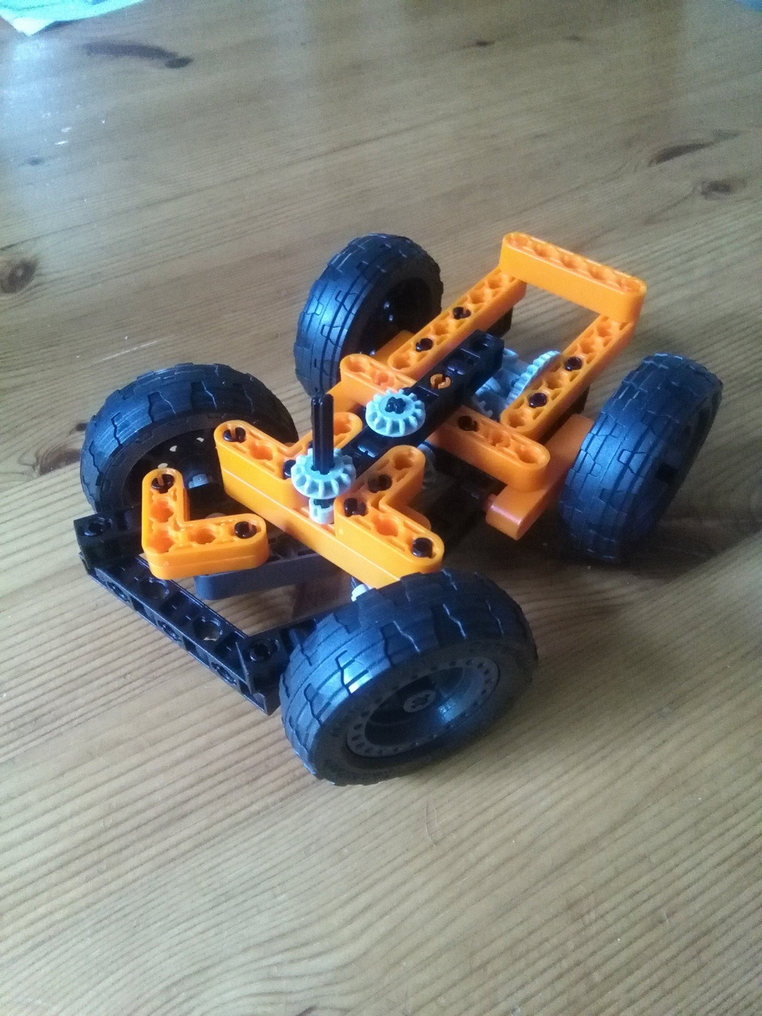

Why continuous servos are handy
Here's a Lego car I built (actually it's a Lego clone). Notice the two grey cog wheels at the top. One is for steering front wheels, one is for driving rear wheels. The Lego model has a differential gear, so this is a very car like model, compared to those robot cars with separate motors for left and right driving wheels.
Each cog wheel gets its own servo. The steering cog wheel has a regular 180º servo, the driving cog wheel has a continuous servo (with the stupid label 360º servo).
So the handy thing is that this only needs the power supply and the data signals. No extra motor driver in between.
