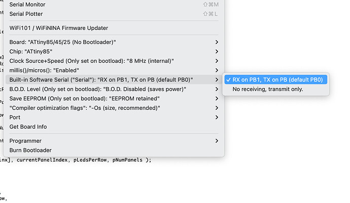

I highly recommend the use of the ATTinyCore board manager when working with ATTiny devices.
This comes with a built in implementation of "Serial" (and many other features) so you can pretty much code Serial as you would for an Uno. I generally use 19200 baud.
Ok, i installed the ATTny core, but i still don't know how to use the Serial Monitor. I tried searching on the internet, but i couldn't find anything. Thx for help in advance
Just connect the Tx and GND from the ATTiny to the Rx and GND of a Serial to UART adapter.

The pins to use should show in the IDE as follows...

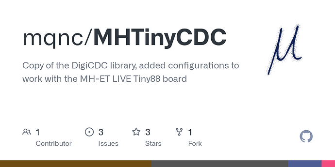

I finally got serial communication working through the onboard USB interface:

I also tried to make it work on another machine which didn't work and made me wonder how it could ever work in the first place (which it did, I swear!)
Summary: doesn't work · Issue #3 · mqnc/MHTinyCDC · GitHub
I also want to get the other Digispark USB examples working (mouse, keyboard, joystick, midi) and publish that here:
GitHub - mqnc/mhtinyusb: Adaptation of the Digispark USB libraries for the MH-ET LIVE Tiny88 board
(but it also doesn't really work yet, I got one letter through CDC and the keyboard worked once)
