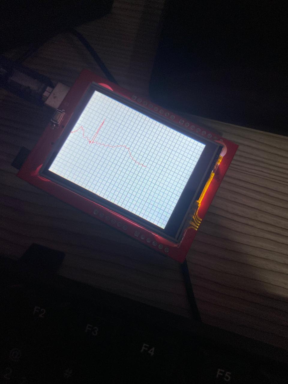

I'm currently working on a ECG Simulator.
The project is to work in the following manner: The tft screen renders a logo, and asks the user to select a graph to show on the screen. However, there are two boards. ESP32 as a transmitting device that sends digital signal to a MCP4725 12 bit DAC that fowards an analog voltage to an Arduino Uno that reads through analogRead(A5) and plots it on the tft screen. My question is, instead of using the wifi functionality of the ESP32 in order to ask the user to select the graph. I'd like the user to touch on the screen on the desired option. Now, how do I know what's the bare minimum wiring on the tft-Uno interface so that the screen still works properly and I can use the other port of the Uno to feed signal to the ESP32 and select the graph from the stored data arrays.

Hi Paul,
So, I agree with you on the point that it's quite complex but the idea is for the ESP32 simulate a human heart and have two separate ends a transmitting board and a receiving board (that makes the role of a ECG machine). I'll do that later, but I plan to test some ECG boards I designed myself.
The thing about the LCD screen is that it's larger but I was not sure if it you be possible to show these kind of graphs with precision on it:

Are any other pins available? For example, how did you discover that A5 was available? A shield usually "occupies" every pin on Uno but may not actually use them all.
Understanding this shield you have may be key to success of your project.
Studying your schematic again, I can see there are no other available Uno pins.
This TFT display, with it's 8-pin parallel interface, consumes almost every pin.
Other TFT displays use the SPI interface, which would require fewer Arduino pins and free up pins for other purposes. Could you find a TFT display shield like that?
