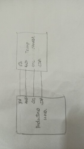

Have you done that ?
Please post your full sketch and a schematic of your project. A photo of a hand drawn circuit is good enough

When starting out with a new device and library, always make sure that one or more of the library examples work.
If that doesn't work, and the device uses I2C, run the Arduino I2C address scanner program to verify I2C communications.

I2C requires pullup resistors. I'm missing these in your schematic. Usually these are provided on the breakout board.
Please check if you have pullup resistors and provide a good photo of your circuit.
