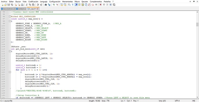

This is the code part of a file called ir_input.h inside the src folder, when I want to modify part of this code, it doesn't compile anymore. I honestly don't know what to change to be able to work with the esp32 pins.
Sound like you have bugs in your modifications.

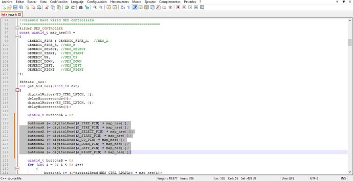

Instead of clocking in 8 bits from each controller, read the 8 values directly:
    unit16_t buttonsA = 0;
    buttonsA |= digitalRead(A_FIRE_PIN) * map_nes[0];
    buttonsA |= digitalRead(B_FIRE_PIN) * map_nes[1];
    buttonsA |= digitalRead(A_SELECT_PIN) * map_nes[2];
    buttonsA |= digitalRead(A_START_PIN) * map_nes[3];
    buttonsA |= digitalRead(A_UP_PIN) * map_nes[4];
    buttonsA |= digitalRead(A_DOWN_PIN) * map_nes[5];
    buttonsA |= digitalRead(A_LEFT_PIN) * map_nes[6];
    buttonsA |= digitalRead(A_RIGHT_PIN) * map_nes[7];
Good morning, thanks for your answer, I tried your code but I still have the same problem, when pin 34 is energized it does nothing, I clarify that I only test the start button to do a quick test, if at the moment of energizing the pin it starts the game, it means that it works, but it doesn't do anything, maybe I'm not locating the code in the right place, I leave you an image of how I modified the original code.
I put the values ​​here and it looks like this

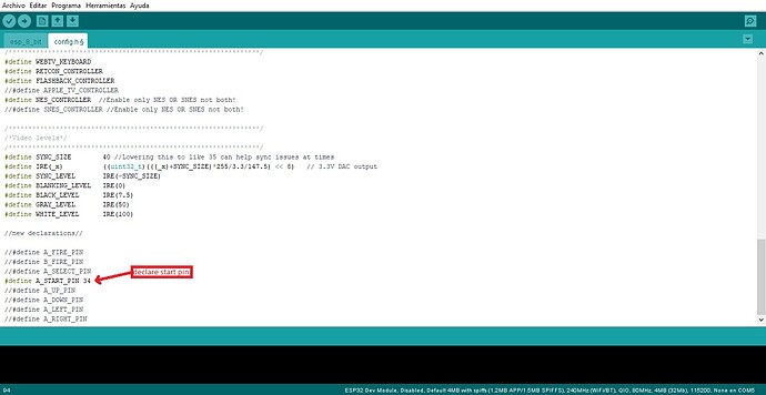

also declare the start pin as 34 in the config.h file

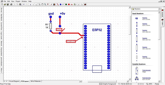

the code compiles fine, it loads to the board, but when I try to energize the pin, it does nothing.
This is how I energize the pin, with a pull down resistor
10k is more suitable as a pulldown resistor.

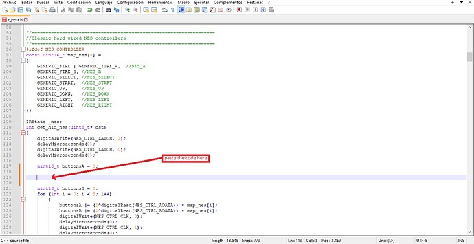

Excuse me, I wanted to show where I inserted the code that Johnwasser recommended
Better... but please post ALL the code.
