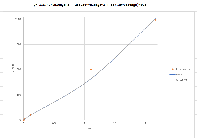

I currently have a TDS (Total Dissolved Solids) module V1.0 from Keyestudio, designed to measure up to 1000ppm of dissolved ionic solids.
My goal is to enhance its maximum measurement capacity by ten times, without replacing the existing probe. DIY'ing a probe is not feasible for me, as commercial probes are usually coated with precious metals, and purchasing expensive platinum is beyond my budget. Through some research, I've learned that the module operates on the principle of an AC resistance measurement circuit, converting electrical conductivity (EC) readings into an analog voltage output. I am looking for advice or suggestions on how to achieve this modification without altering the probe. Any insights or guidance would be greatly appreciated.

I conducted tests with the module using solutions of known conductivities. The results, shown in this table, indicate a fairly linear relationship: Conductivity Results
Using these results, I was able to fit a polynomial model for TDS calculation in Excel:

  • The part of the circuit in the yellow square (on the schematic) is unclear to me. Any explanations would be helpful.
  • Based on my experiments, I believe changing the R12 resistor might adjust the module's upper measurement limit. Is this assumption correct, and if so, how can I calculate the necessary resistor value?

Is a simple inverting amplifier. The gain is -R10/Rtds, where Rtds is the unknown resistance of the probe. You can change R10 to increase or reduce the gain.
R12 is probably there to prevent oscillation or hangup if no probe or no conductive solution is present (in which case Rtds = infinity). Otherwise R12 has no effect on the circuit.
Since the LM324 is a very old design, with positive output voltage limited to about Vcc - 1.5V, you won't get much, if any, change in measurement range by changing the gain of the circuit. You need a rail-to-rail op amp to extend the output voltage range. I'm surprised that you get a voltage somewhat higher 2 V, but that is probably the upper limit.
You can certainly reduce R10 by a factor of ten, in which case the theoretical upper concentration limit of would be about 20,000 uS/cm, but you lose measurement resolution by a factor of 10.
A much easier way to extend the range toward more concentrated samples is to dilute the initial sample by a known amount.

R12 forms a voltage divider with the TDS probe, allowing for the actual resistance measurement. The voltage across R12 is then amplified by opamp C, passed through the rectifier and the peak detector to the analog output.

Looks to me like changing R12 would change the range.
No, it does not.
By the action of the op amp, the voltage at Vin-, a virtual ground, must be very close to zero and very close to equal to that at Vin+, which is grounded. So, no significant current flows in R12, and it has no effect on the circuit unless the probe or solution is removed (in which case it forces the op amp output to be zero).
The gain of the op amp is R10/Rtds, or R10*sigma, where sigma is the conductivity, 1/Rtds.
Capture
Much nicer fit if you don't force it through the origin:
