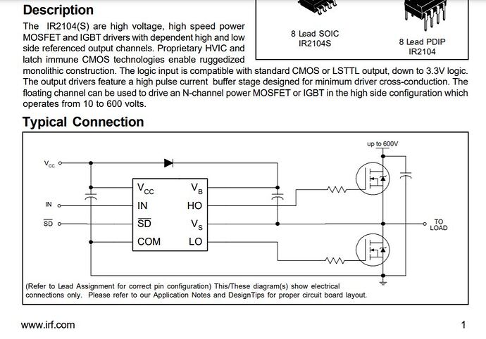

While designing my motor driver on shoe string budget I ran to a sort of contradicting information.
Attached picture is from the datasheet of a driver similar to IR2104. I find the given capacitor values a bit baffling since the Cbs is 10 bigger than Cdecouple.
Should I follow the generally accepted 10-20 times Qtot for Cbs and 10 times Cbs for decouple or should I stick with the values in datasheet?
I'm kinda leaning towards the general rule so that I can change to IR2104 in case these super cheap alternatives are bust.

Use the datasheet. That’s why the manufacturer publishes one. To ignore the datasheet is akin to shooting ones self in the foot.

I am a bit biased about the data sheets, they were written by engineers that know the part, general rules in part are by people not wanting to read the data sheet or do not understand it. The parts are guaranteed to the data sheet, not to what somebody thinks it should be.

For the capacitors: you have to look in more detail at the actual workings of the part to know how they are being used. The values suggest that C1 is just for power supply decoupling, while C2 is the reservoir used to switch both transistors.

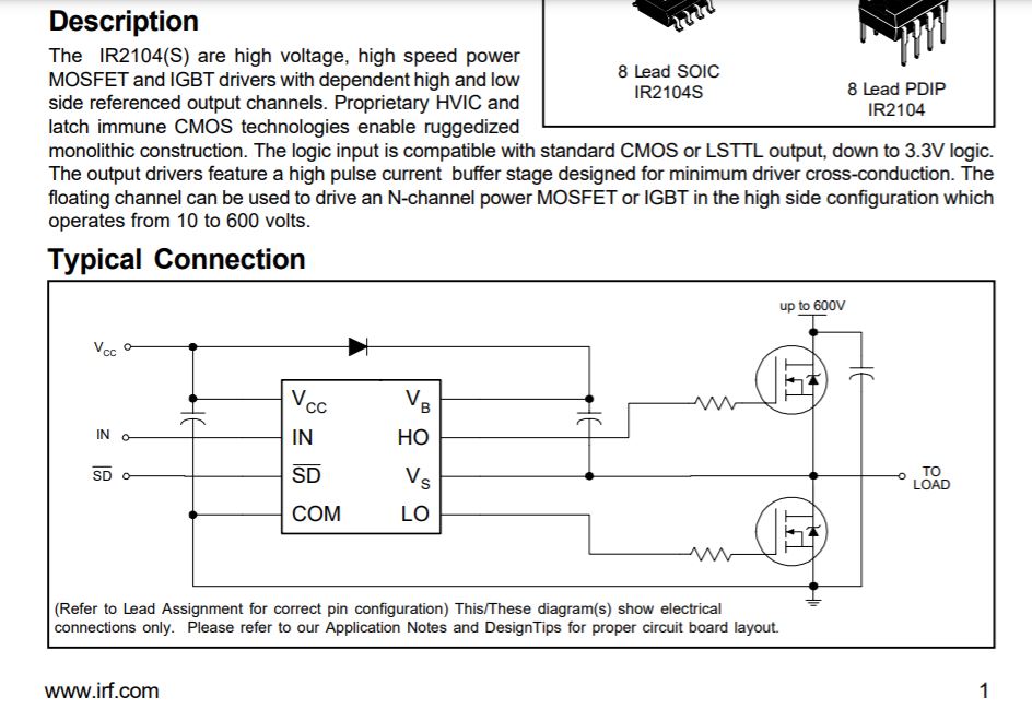

I do see an interesting difference in the schematics posted in #1 and #3. In the first capacitor C2 appears to be connected to the midpoint of Q1 and Q2. In the second there is no such connection. That makes for a huge difference in overall behaviour.
The second schematic also has a third capacitor across the two output transistors.

The way I read these schematics is that the C2 connection is the same, the EG2104 just draws it on the right hand side of Q1&Q2. Both still have a connection from VS to midpoint of halfbridge where the lover leg of C2 also connects. Both schemas also connect C2 top to VB and diode.
I don't know if there is big difference but I guess I'm going to find out.
I understand the C3 in IR2104schema as the power input buffer caps.

The chip's decoupling cap is what recharges the bootstrap cap, so it needs to be 10+ times larger than the bootstrap cap to avoid too much supply droop.
The bootstrap cap is what charges the MOSFET's gate capacitance, so it needs to be 10+ times larger than that to avoid too much bootstrapped supply droop. It also has to hold
enough charge to cope with gate leakage current over the period of PWM invoved.
This is all basic physics so you don't have to worry about whether the datasheet is right
or not, physics is always right for these things!
For instance if the effective gate capacitance is 3nF, 33nF Cboot and 1uF Cdecouple ought
to work, although larger might be better (especially for slow PWM).
The effective gate capacitance is best calculated as total gate charge / 10V, since this
is the worst-case demand for charge.
