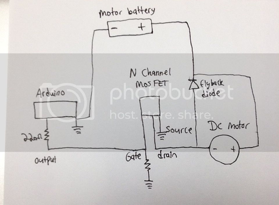

I'm using an N-channel MOSFET to complete the circuit and make a motor spin (no PPM, just connecting the battery + to the motor +, and the battery - to the motor -). It's a small dc motor from a toy car. However, the FET starts getting extremely warm as soon as I connect wires to the source and drain and my meter shows continuity between the source and drain.
I have a 10K pulldown resistor so I don't know how the source and drain can be connected. All my common wires are connected, and I've tried to replicate a number of Arduino DC motor examples with no luck. I got things to work perfectly a week ago, now that I've rebuilt my circuit I can't get it to work at all. The only other thing to not is that my meter shows continuity between the + and - leads coming off the motor.
Here is my circuit:
Any suggestions apprecaited!

Which mosfet.
Logic level or not.
Leo..
Thanks Leo. I linked to the original post below. It's a logic level FET.
I followed multiple arduino examples that people suggested and got everything to work perfectly a week ago. I simplified it to a single MOSFET and it's always on and I'm banging my head against the wall.

Figured it out. I tried a new FET and it works like a charm! (four hours later):wink:
Now I have to figure out how to test the FET wasn't working to see what went wrong. I swear sometimes the simple things are the hardest.
There is an unlabelled resistor in that diagram - is it 10k or something much bigger than 220?
Most MOSFETs have no protection on their gates so should be handled with anti-static precautions.
Mark, it's a 10K pulldown resistor to keep the gate low unless the arduino tells it to go high.
