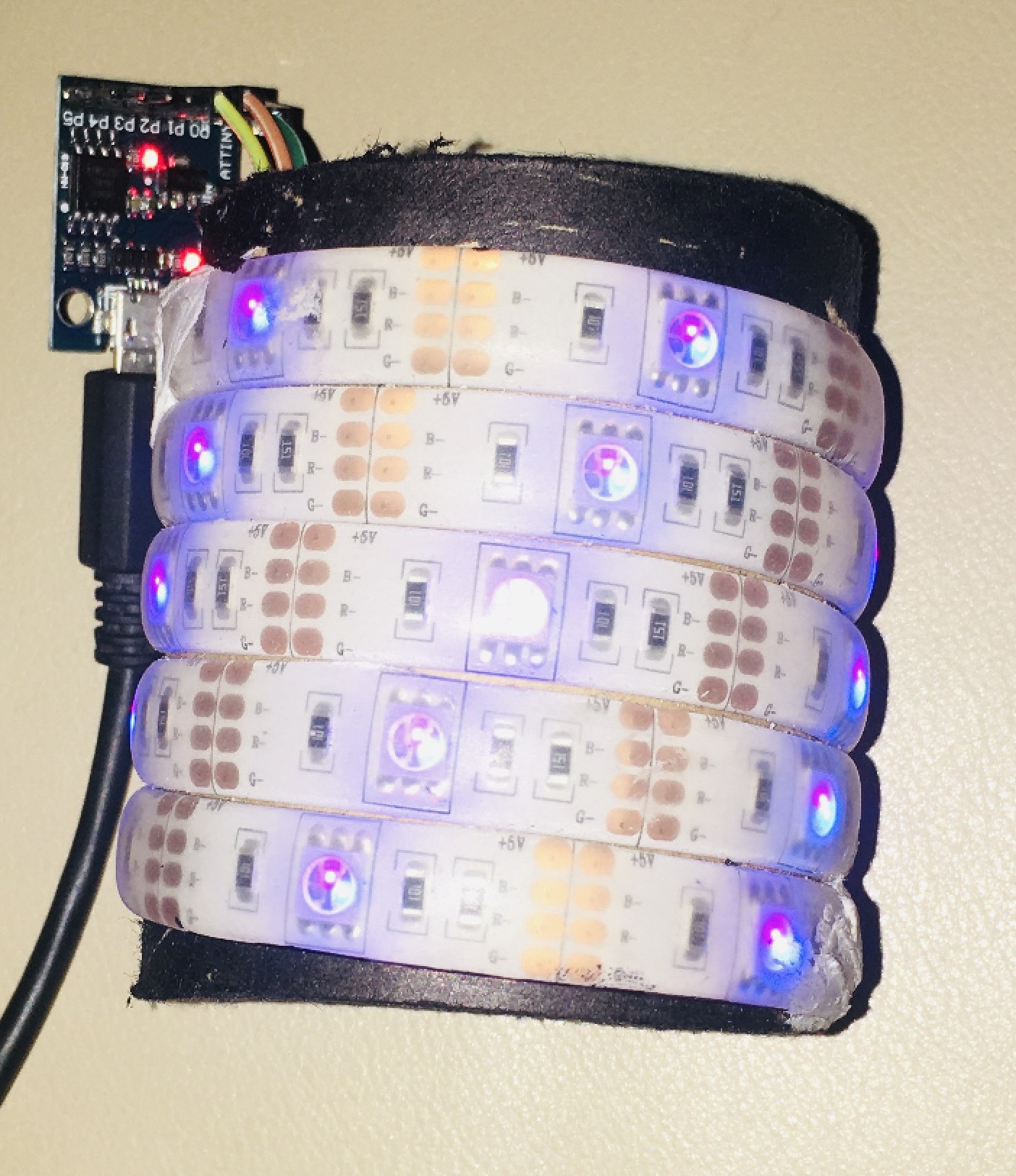

DigisPark.
Finally we have a Digispark to have test run.
Because RED is one of the essential color, it is important that you tape the red LEDs in the CPU module, we normally cut them off.
The sketch is nearly identical to the one on Post #1. We have the habit to write one every time.
Anyway here it is:

Happy Mosquito Free!
