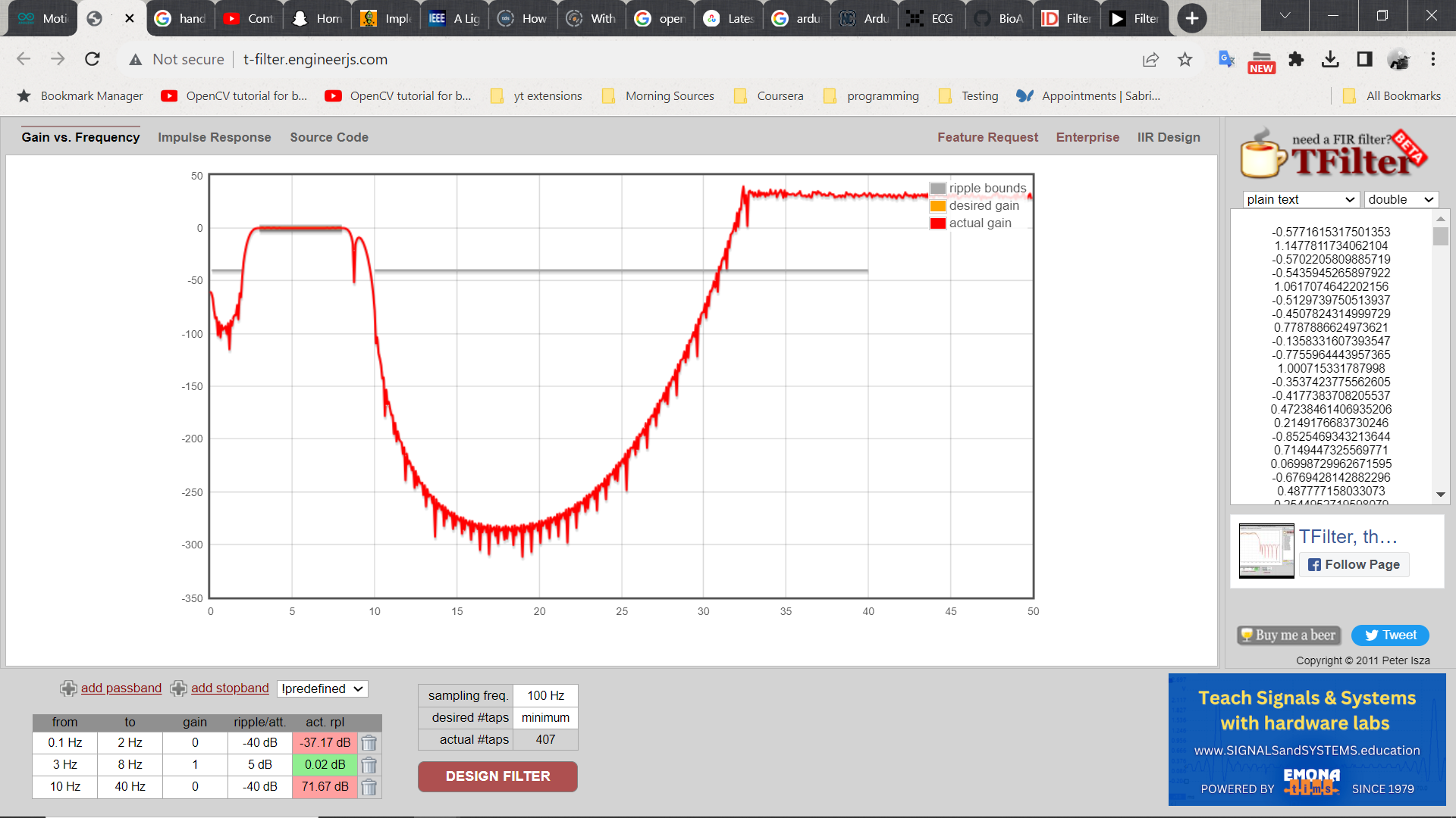

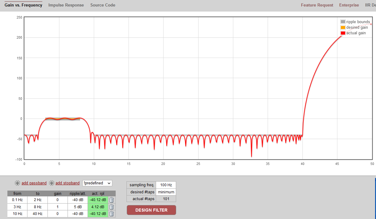

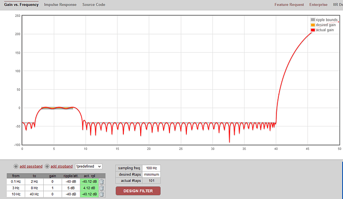

I've used this calculator with success, and this result looks sort of promising:
Thanks! I tried these input values but got something different, it has 407 taps instead of 101, see attached. I just added bands and types in the values from your plot. What am I missing?
No idea. It worked again for me, maybe it is browser-dependent. Try changing the sample rate and the frequency cutoffs.
On the other hand, take a look at the generated code for the 101 tap solution. I'm suspicious that the coefficients are all very large numbers. This looks like a numerically unstable result.

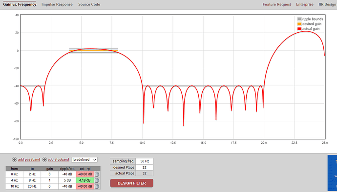

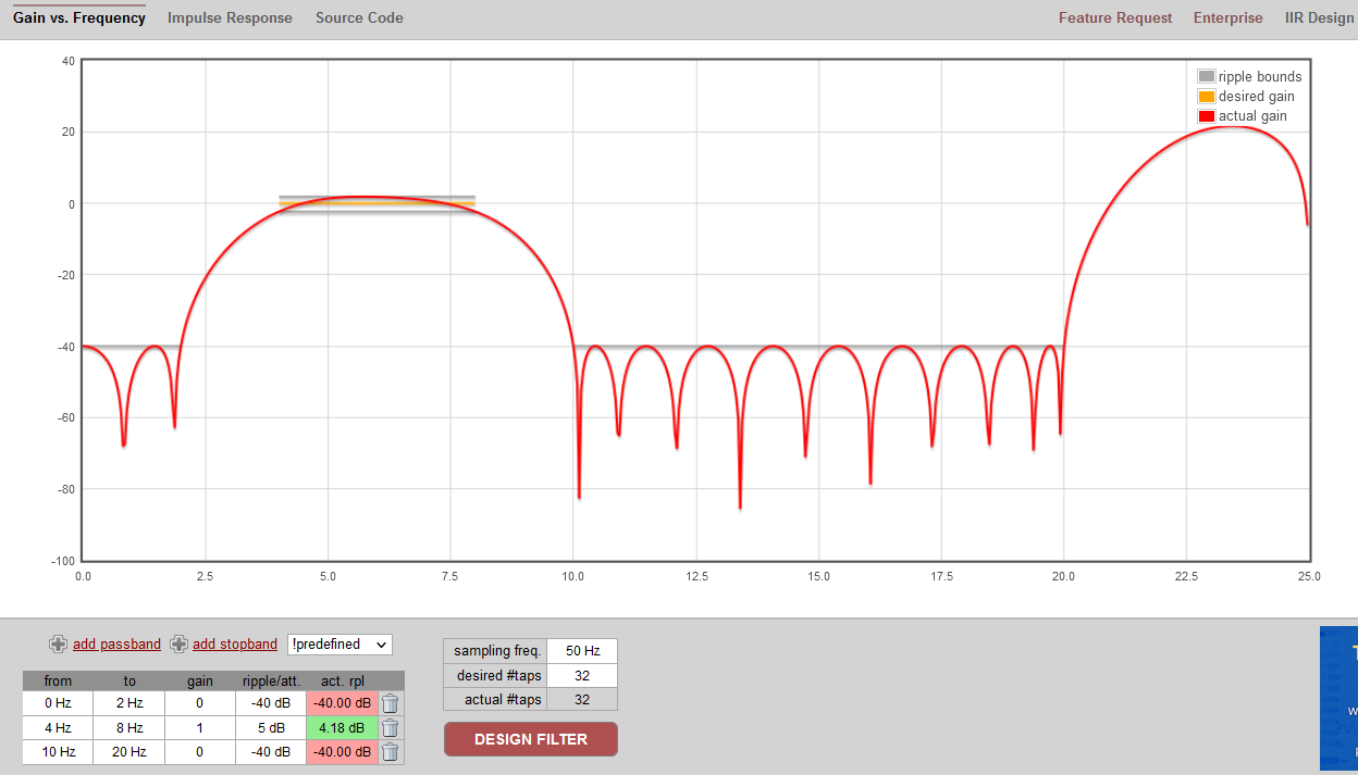

I ran it again using 50 Hz sample rate, and got a MUCH more sensible result, with 32 taps and reasonable coefficients.

FIR filter designed with
 http://t-filter.appspot.com
sampling frequency: 50 Hz
* 0 Hz - 2 Hz
  gain = 0
  desired attenuation = -40 dB
  actual attenuation = -39.99747410361548 dB
* 4 Hz - 8 Hz
  gain = 1
  desired ripple = 5 dB
  actual ripple = 4.177219343095732 dB
* 10 Hz - 20 Hz
  gain = 0
#define SAMPLEFILTER_TAP_NUM 32
