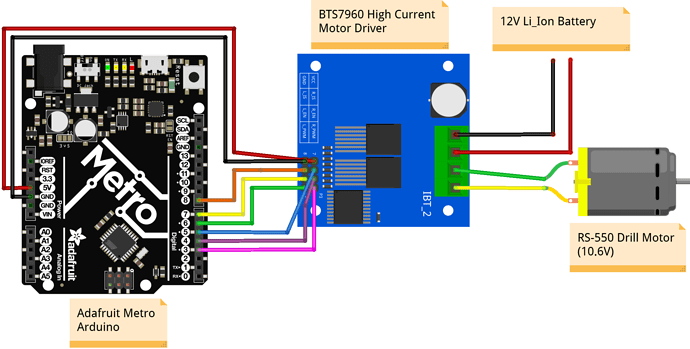

Thank you all so much for your help! I finally have the motor running using the BTS7960 Motor Driver Module. I'm still trying to figure out the current sensing bit, so any help is appreciated! I've attached a picture of how I've wired everything, but I'm thinking that I need to connect the R_IS and L_IS pins to A0 and A1.
I've searched all over on how to use the IS pins and haven't found anything useful yet, and I don't really under the BTS7960 Spec Sheet. Can I just connect them to A0 and A1, put them on the serial monitor, and have them tell me what the load current is? Thanks a bunch!
The data sheet shows that you connect a resistor (typ. 1K) from IS to ground, and measure the voltage across the resistor.
The data sheet also explains that the current output by IS is proportional to the load current IL, with a ratio of typically 8500. However, you must calibrate your measurements by measuring the voltage across the IS resistor, for one or more known load currents.
IS = VS/R(IS)

@jremington and @ballscrewbob thank you so much for your quick replies! It seems like the motor driver is already connected to a resistor, as shown in this schematic.
I've connected the R_IS pin to A0, and L_IS pin to A1, but the values only jump back and forth from 33 to 66. Stalling the motor with my fingers doesn't change these values, and I'm unsure what I'm doing wrong. The end goal is to have something that looks like this.

Start simply, by testing the driver with a dummy load (a resistor) instead of the motor.
For example, a 1 Ohm resistor will draw 1 Ampere per Volt across it. You will need one with a large power rating, like 25 or 50 Watts and limit tests to short periods.
Keep in mind that the IS output is also the Fault Indicator.
OPs diagram;

Hi @TomGeorge! Thanks for posting the diagram. Yes, I've googled it extensively, but there isn't much information on how to use the IS pins. Most of the other projects don't use those pins.
