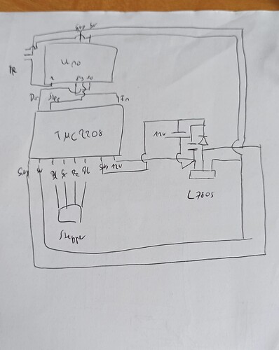

I soldered my board yesterday and it worked. Printed a case overnight, tried again today - nothing.
I have a 12 supply, l7805, Arduino Uno, tmc2208 and a nema 17.
I'm trying to get what component isn't working as intended, but I don't know how to check the tmc2208 and the stepper, since I only have both components only once, so can't check one without the other...
I already checked if 12 &5 v are supplied to the TMC (yes). I tried checking the voltage of TMC to nema, it was jumping between 0 and 0.05v for the two pairs. So I guess it's the driver, anyone can reassure me/tell me what to check to be sure?
Dont know how it broke, since i bought it(and the stepper) just for this project..

Thanks for the hints, and sorry for not following the basic rules :frowning:
thats a low effort schematic, but i hope it has everything needed.
the soldering part is far from good but every connection is working.
i dont think its the uno, based on the fact, that it worked fine yesterday and i havent changed the code?

Problem: The motor isnt moving anymore. arduino, ir-reciever and driver are supplied with 5v (checked), the driver also with 12v (checked). ir reciever gives visual feedback, workes(checked via serial). Arduino is working to (serial).
I want to find out, what component isnt working anymore (should be nema or tmc), but dont know how to do this. Hope this is useable?
I really cannot follow your schematic, I am trying to find the power source and what it is rated at. The links to the technical information on the parts I cannot find. Schematic flow is top down, left right. How are you measuring the voltage? Are you using solid or stranded core wire?
Please label and number pins, and explain the 7805 circuit. What is the purpose of the diode?
This is how a 7805 regulator is normally wired and how the circuit drawn. The output capacitor is required.

Hey all,
thanks for all the input. i already ordered some new drivers (why not get better tmc2209 if they cost nearly the same). well: nothing changed. Since i have tried the curcuit on the breadboard before, and hadnt changed this, i was able to try out, if anything was faulty regarding the soldering. Still nothing.
Well, went back and remembered, that i changed the code from pin 7,8,9 (enable, dir, step) to 8,9,10 for cosmetic reasons (3 pins in a row instead of 1 and 2). Dont know if theres some hardware mistake on that one or if the arduino cant send the correct signals from the higher pins, but after going back to 7,8,9 everything was working again.
So: lesson learned: dont be stupid :slight_smile:
I have two capacitors, i honestly forgot about the small one (+5v to gnd).
The diode is to avoid damage to components in the 5v circuit. Thanks for the advice, next time i will sketch the circuit on the pc before creating it in real life, makes things easier, i guess?
