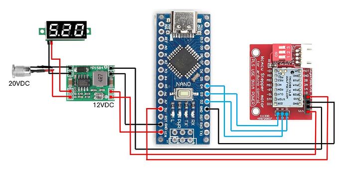

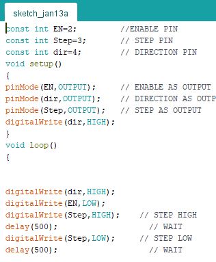

I am trying to build a very simple setup to run a stepper motor from.an arduino nano clone, currently all i get is the motor pulsing but not moving, my code and schematic are attached.
Can anyone see obvious reasons why this doesnt work?

It will be a more informative schematic, please include the stepper motor and its connections.
Thanks.. Tom...
Sorry but that is not a schematic. It is a physical layout diagram, which is only suitable for telling an unthinking person how to assemble something. It is not the sort of diagram that is any use for communicating what circuit you have.

Your physical layout diagram fails to show any wiring between the output of the driver to the motor driver coils, and also what that display actually is.

I found a description of a similar driver board on the Internet that allows to check the wiring if the driver (assuming that it corresponds to your board). It looks as if that's ok. But that's a guess...
You may look at this sketch
https://wokwi.com/projects/385268324618418177
in Wokwi and test it in your application (after changing the pin assignments where required). The main difference is the use of microseconds delay rather than millis

Thanks to those who contributed, problem now solved after realising the TMC2208 was jumpered for UART not step/dir, after some tricky soldering to move J2 to the other position all worked okay.
