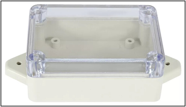

Hi @st_4489665. The simple solution I have used is to get an enclosure with a transparent lid, something like this (they are available from any of the usual sources of electronics components):
then drill holes in the lid and use machine screws to mount the display to the inside of the lid. This way I didn't need to worry about things like cutting a hole and a bezel. It provides protection for the display. The waterproof nature of the enclosure is not compromised (as long as you take measures to make a seal on the screw holes).
You do need to be careful when drilling holes in this type of plastic to avoid cracking it, but it can certainly be done and there is plenty of information on that on the Internet (I used a drill bit specifically designed for this application).
