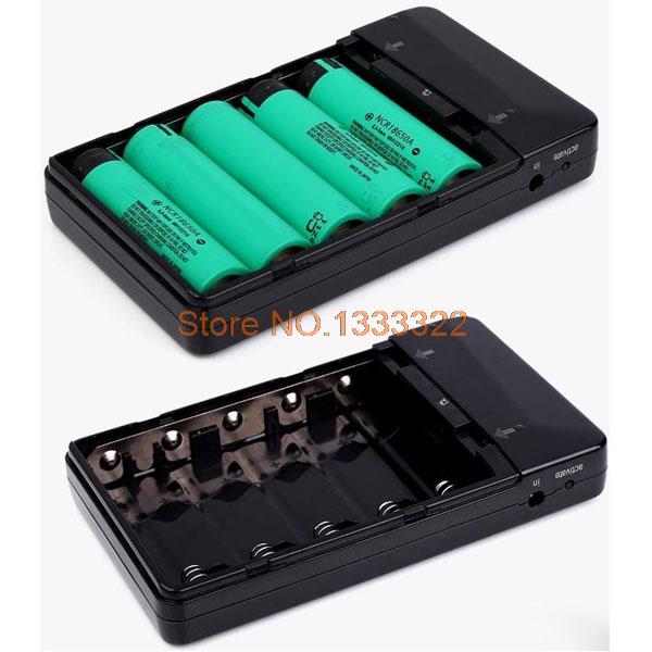

My advice if you really want to charge multiple 18650 at the same time, you can either take apart an old powerbank (eg:xiaomi powerbank) and use it's circuitry to charge all of your batteries at once or you can buy a power bank diy kit case from aliexpress or banggood or ebay that allows you to charge multiple 18650 cells simultaneously as they have dedicated charging circuitry for multiple cells. They cost around 5 or 6$.
Thank you very much for this advice but in the images that you have posted they have connected all the anodes together and all the cathodes together. My question is that wouldn't they also do the same thing as a single TP4056 charging multiple cells? Please reply fast I'm already working on my power bank project
