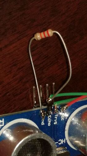

DaveEvans:
Well, you could buy one. Or try a diode OR gate if you have a couple of diodes and a resistor.
I guess something like this?
I have a couple of diodes and resistors lying around, I might actually try that.
zhomeslice:
I have succeeded in triggering all at the same time using interrupts :slight_smile:
each echo pin goes to a unique input and pin 2 is tied to all trigger pins
all triggers activate at once
I was thinking about doing it like but, but I was a bit afraid of getting weird results if the echo from sensor A ends up in the receiver for sensor B. Do you notice any issues with crosstalk between the sensors?
sparknburn:
So lets look at what could change with the wiring that may resolve you concern
If we were to hook the first sensor trigger pin to the arduino pin 2 as I suggested but hook the second sensor trigger pin to the echo pin of first sensor. continue this for each sensor 3's trigger to 2's echo, 4's trigger to 3's echo.
Datasheet: https://cdn.sparkfun.com/datasheets/Sensors/Proximity/HCSR04.pdf
The trigger pin only fires after the pulse to it falls the pulse has a minimum "Using IO trigger for at least 10us high level signal" but I didn't see a maximum limit on the datasheet. so the above method would fire each sensor in sequence. and you timing of the rise an fall of the echo pin is what you would use to detect distance. using your simple diode circuit you could achieve multiple sensors with 1 trigger pin and 1 input pin.
The more I type the more I'm still favoring the all at once method because the actual sensor only senses a 15° window. meaning that any pulse that is able to reflect back would be a indication of an object that is within 15° . Since the start pulse is exactly the same on all devices the result is more accurate even if it is a reflection of a reflection is detected (something is there but its just stealthy) that actually returns a signal. My thought is that this is more like a submarine that sends out 1 pulse and listens in all directions for each resulting echo if 2 sensors pick up the same echo you can triangulate the exact position on a flat plane

I have always just tied the trigger and echo pins together on the 4 pin sensors, and it works just as fine as if there was a single combined pin like on the 3 pin versions. Is there a long term issue that makes this a bad idea?
cmayer777:
That should work so you are triggering the pin then changing it to an input for the duration pulse from the echo pin?
the trigger pin ignores any further input till the echo pin completes its pulse. and there is a slight delay between the trigger and the echo pin going high. How would you start your timer for the echo pulse?
Hi.
I`m just wondering what value resister you used?
Thanks,
Greg.
gregsharp110:
Hi.
Thanks,
Greg.
I just grabbed a 2.2K resistor but any resister in the 1K to 10K should work.
