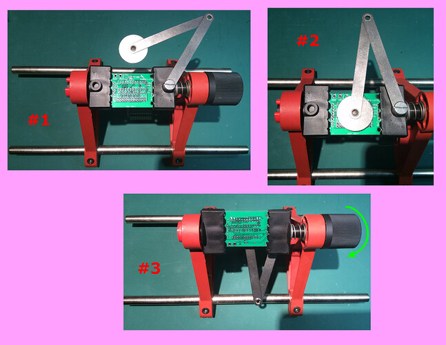

If you are doing only one PCB then a device like this is useful (made by Weller).
In #2 you capture your through hole components with the movable arm (has foam pad on it).
In #3 you rotate the (k)nob ( :astonished: ) to expose the bottom side for soldering.
See link HERE for PCB HOLDER, JIG, ESD, WELLER ESF120

I have used the Weller unit for years, have to replace the foam now though.
Grip looks like it has a nice third hand capability.

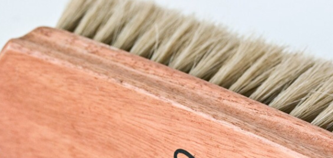

Never tried it but may be a soft natural brush might work also.
I use a Shurline brush when making PCBs to speed up the etching process.
It has brush filaments on a bed of foam maybe try it.
Buy them at HomeDepot.
