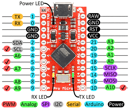

My Arduino Pro micro doesnt have A4 and A5 Pins
I want to use the Wire.h library for my project and im following a guide at https://www.instructables.com/Communicating-With-Two-Arduinos/
an noticed, that my board doesnt have the A4 and A5 pins, but it has A0, A1, A2, A3
Can i somehow change the pins in the software or is there any other workaround?
are you noticed there and yours are completely different boards?
Arduino sell no board with name "Micro Pro". so what board do you actually got ?
Did you mean PRO MINI? A4 and A5 are on the inside of the board above pins 12 and 13. A6 and A7 are above A3 and VCC.
A Pro Micro doesn't have A4 and A5. And it's a 32u4 based board, not an ATMEGA328P board.
If you mean a Pro Mini, it does have A4 and A5. They're the holes just inboard from A3, and may be labelled SDA and SCL, or may not be labelled at all.
Sparkfun Pro Micro have SDA and SCL in pins 2 and 3, respectively (like Arduino Leonardo).
Head slap! I didn't realize the OP was actually looking for the I2C pins. :flushed: That'll teach me not to read closely.
Attention @kuglatec ! The tutorial in the link has a gross error, the I2C bus needs pull-up resistors (47K or less) in both cables (SDA & SCL), the tutorial does not even mention them.
