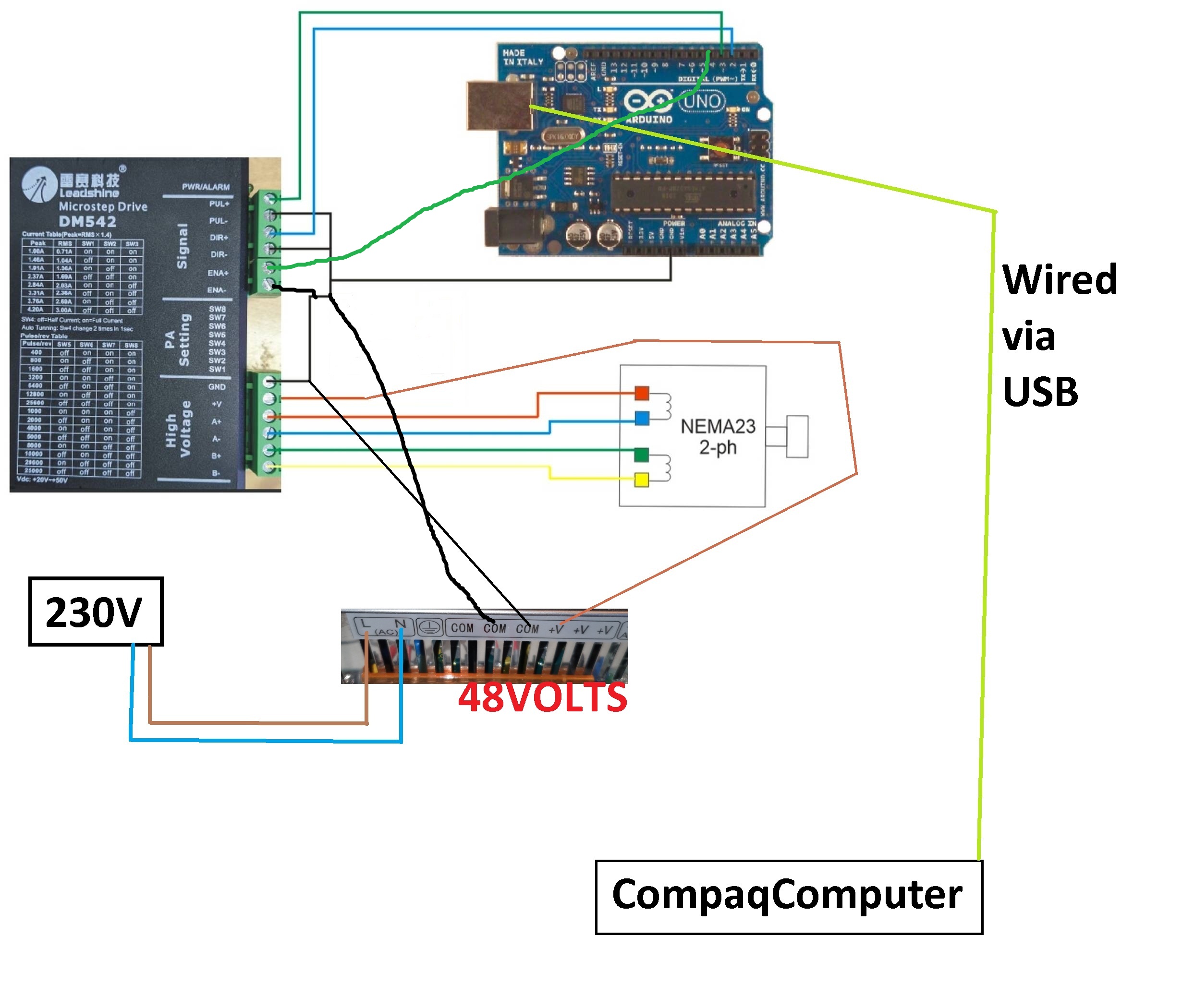

I need your help. My Computer has been demolished because of my work with arduino and a 48V Power supply.
I was coding via Arduino. What did I make wrong ? Here is the shematic I used.

The connections I crossed off in red should not be there.
However, unless the DM542, 48V supply or computer is faulty it would not have destroyed your computer.
Thanks man
I also suspected these two connection. The EN- Pin on the driver should only be connected to the IC (Arduino).
But as I said, that probably did not cause your computer to be destroyed
You either had somethig else connected wrong or the power supply and/or motor driver is faulty,

@jim-p I am pretty sure, that is was because of the power supply. Each time I startet the supply (at the same time the UNO was connected to COmputer), my Computer alerted me of a wrong USB Device. I think it's because of power backdrop or etc.
@zwieblum sometimes learning the hard way is better, because you won't do the same mistake ever again ![]()
@jim-p Eather the power supply made a back-drop of current, or the motor Driver (DM542) made a backdrop of current. Maybe the MOTOR ? It is a huge 48V 4,2A Motor.
I would buy a new good quality power supply.
You may also consider using a USB isolator module.
I guees that this was the problem. It was one of the cheapest ![]()
What is an USB Isolator ? Is this a correct one ?
That or something similar. Again you get what you pay for. I see those modules ranging from $1 to $35. I have personally never used one.

Probably not. You have a faulty supply where the line voltage is connected to one of the outputs or to the outside metal. Buy a new one
