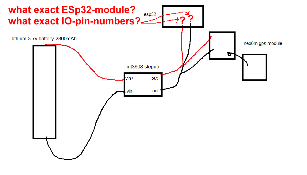

i didn't post the schematic because it's super simple, but here it is
esp32
out+ > 5v0
out- > gnd
gps
out+ > vcc
out- > gnd
as for the connections between the esp32 and the gps
rx > gpio 17
tx > gpio 16
as i said, i have regulated the stepup to 5v a while ago, but now i have measured the output voltage and less than 4, which is the voltage my battery currently has.
Why?
I do not see a schematic, just an incomplete wireing diagram.

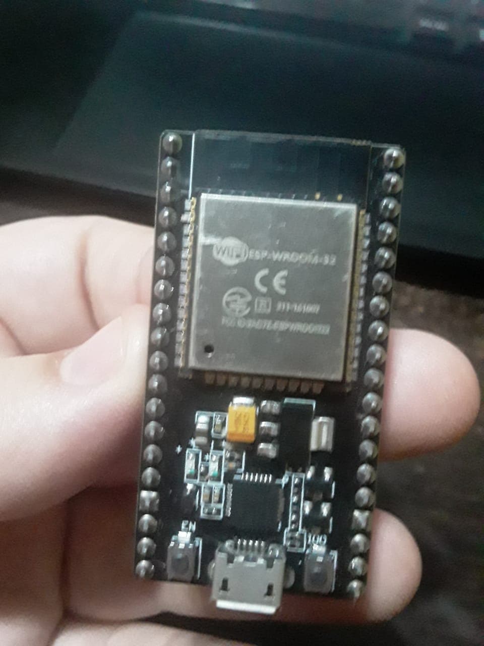

this one.
