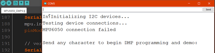

My MPU 6050 is not connecting
I am using the example code for MPU 6050[MPU6050_DMP6]

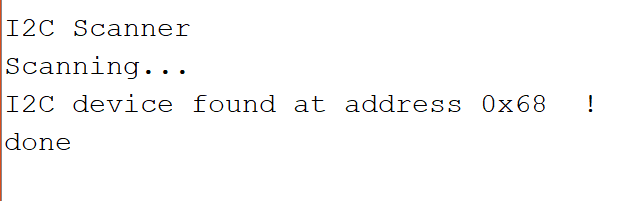

Start with a I2C Scanner sketch. There is a "i2c_scanner" sketch in the Arduino IDE in the examples menu.
Its this, what next?
Post your test code.
Post a link to the library that you are using.
What I2C address is the test code using?

So what address is used in the code?
#define MPU6050_ADDRESS_AD0_LOW     0x68 // address pin low (GND), default for InvenSense evaluation board
Please post your complete code please.
To add code please click this link;
here is the code from the library mention above

I suggest that you try a different library just as a test. There are several MPU6050 libraries available through the IDE library manager. The libraries available from library manager are more likely to be maintained and up to date with the IDE versions.
There was a problem with MPU-6050 modules which had the wrong WHO_AM_I value:
https://forum.arduino.cc/t/mpu-6050-a-module-problems-who-am-i-reports-0x98-not-0x68-as-it-should-fake-mpu-6050/861956.
Could you run that sketch at reply 10 ? It prints the WHO_AM_I register.
It is possible that the I2C bus can barely accept a I2C Scanner, but fails when real data is transferred. If your WHO_AM_I is okay, then we can look into this.
The MPU-6050 is obsolete and has not been manufactured for years. Any that you buy today are extremely likely to be factory rejects, counterfeit or nonfunctional fakes.
here
Welcome into the twilight zone of fake or counterfeit or rejects or wrong chips !
That chip is not a MPU-6050.
I don't think so
We know all of that. See that other topic: https://forum.arduino.cc/t/mpu-6050-a-module-problems-who-am-i-reports-0x98-not-0x68-as-it-should-fake-mpu-6050/861956.
It might be a ICM-20689 sensor (or not) and it might be compatible with the MPU-6050 (or not) and it might actually be a genuine ICM-20689 chip (or not). We don't know.
The "raw" example does not use the function to check the WHO_AM_I register, so it just runs.
ok so what should i buy now? i mean is there any replacement sensors for the mpu6050?
Many. Buy breakout boards from reputable suppliers like Pololu, Sparkfun, Adafruit, etc. and you will also get wiring instructions, working code examples and forum support.
If you want ONLY a gyro and accelerometer, this is a much improved replacement for the MPU-6050: Pololu - LSM6DS33 3D Accelerometer and Gyro Carrier with Voltage Regulator
