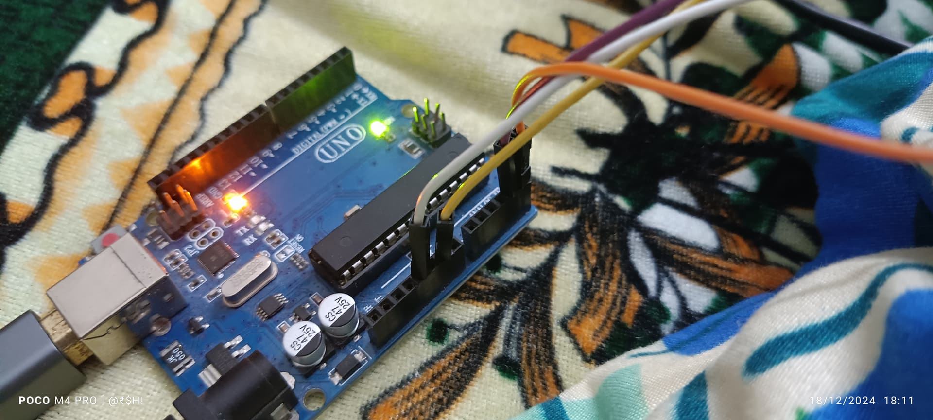

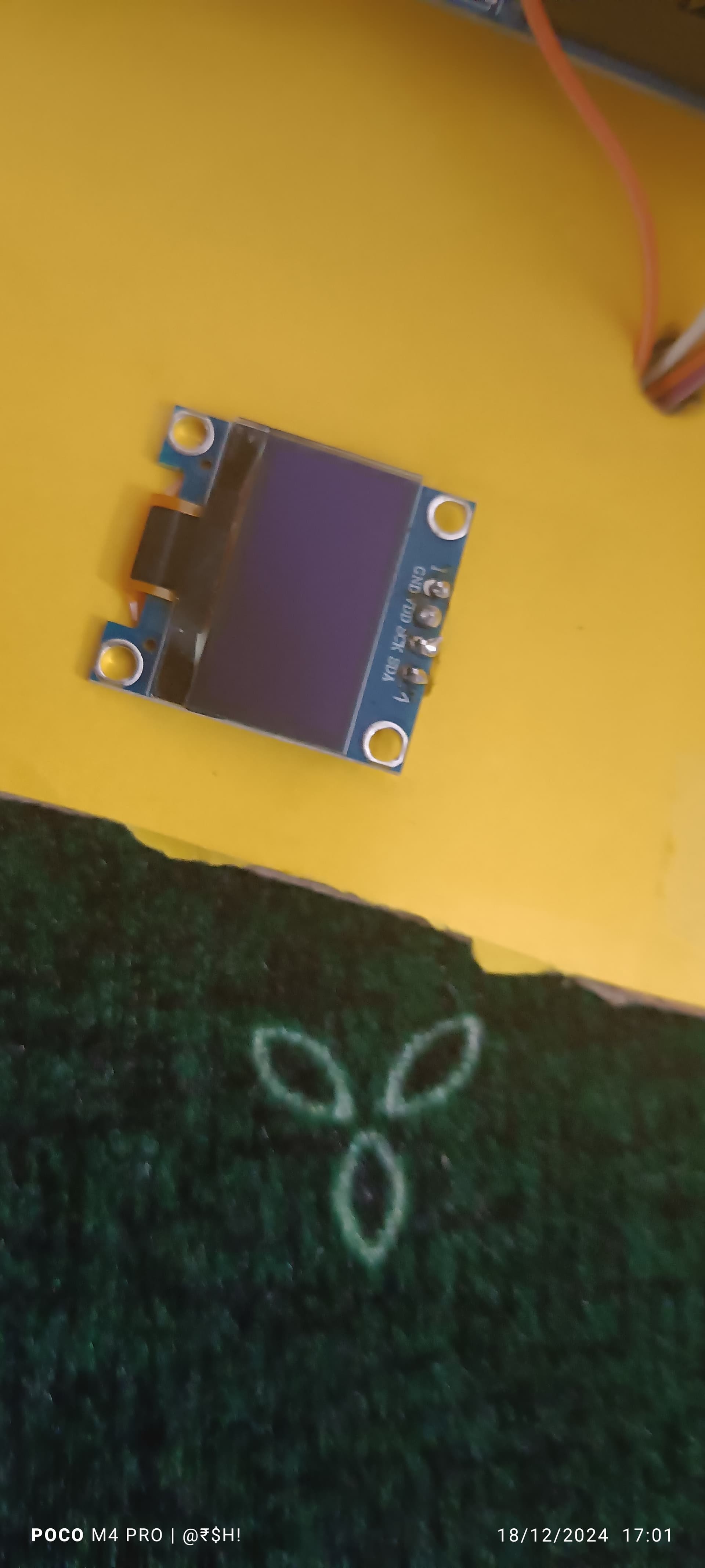

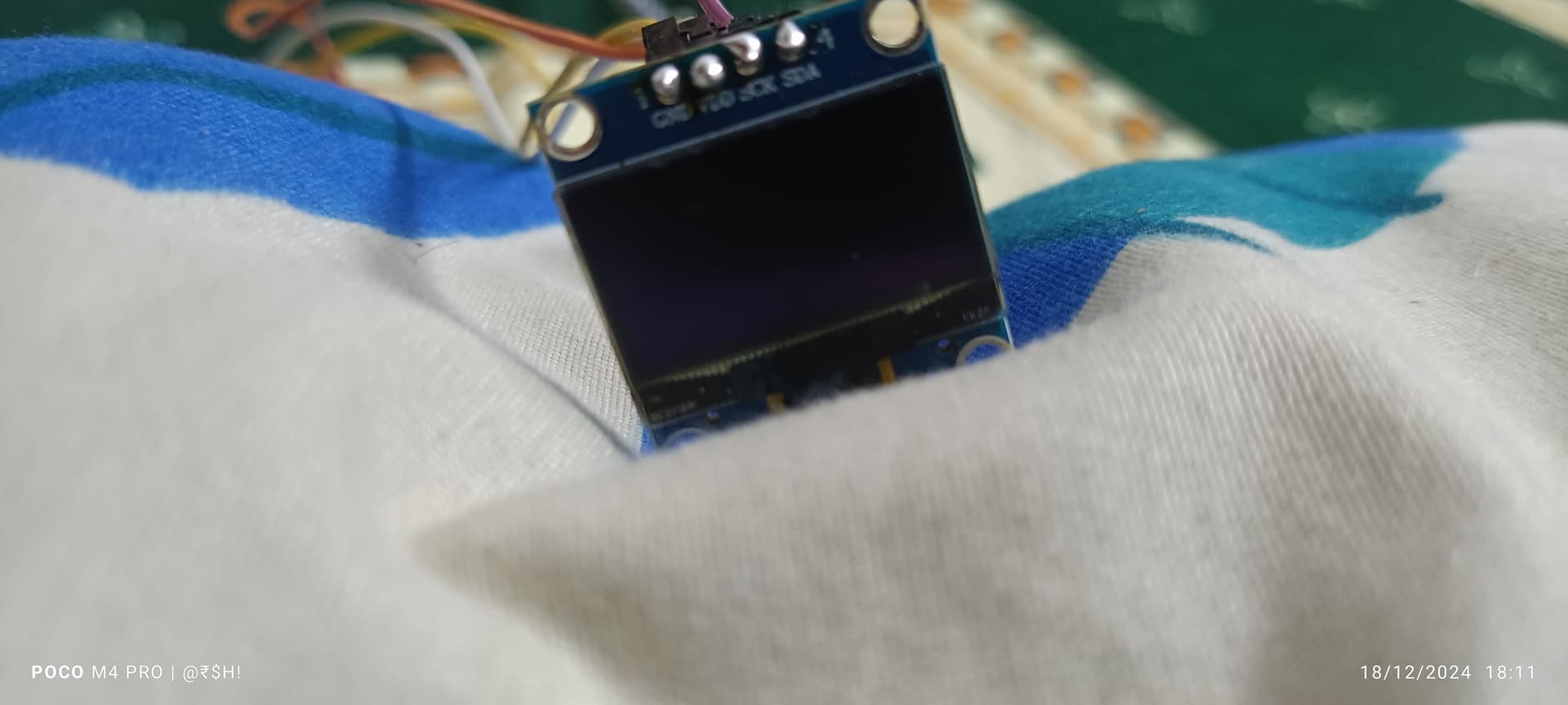

My Oled display is not working
I am making a project for my maths exibition. It is based on this video I will share below. It requires a Oled display to show information
. I have connected each and every wire accordingly to each component of my project. But, when I switch on the Arduino, The Oled display does not work and remains still like the sun. Please Help Me
Here is the link to the video. Both the codes and the diagram are shared in the comments.

Please post your sketch here, using code tags when you do, and a schematic showing all components, how they are connected and powered. A picture of a hand drawn circuit is good enough
what OLED display and host microcomputer are you using? give links if possible?

did you test the display in a separate program before attempting your complete program
e.g. from File>Examples>ssd1306>Demos

Yes,I did when it arrived and it was working.
But when I did it again on your suggestion, It is not working now.
if the display uses 3.3V logic the 5V logic of the UNO may have damaged it
I just brought another oled display.
