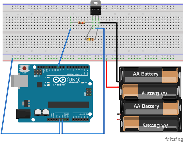

I’ve got an Arduino MKR1000 that I’m trying to connect to a 4-AA battery pack, a RFP30N06LE 30A 60V N-Channel Power Mosfet and a push button. My goal is to have the MCU program run once at each push and then turn off the board until the next push, for the sake of low power consumption. The program is a simple and straightforward test: it sets the pin mode to output for the control pin and writes a HIGH. Then it makes the built-in led blink a few times and finally it writes LOW as the control pin output.
I’ve attached the breadboarding schematics I’m doing (no push button yet, I can’t even make it work as is so far so…)
I’ve tried most of the solutions I’ve found online:
  • A 10K pulldown resistor between digital output pin and gate to make sure voltage stays low when pin 10 = LOW
  • A 100K resistor between gate and source to avoid gate floating
I’ve read that I should connect the Arduino and the battery pack to a common GND, I’m not sure how to do this while keeping the mosfet into the closed circuit (and therefore creating an open circuit when no voltage is applied to its gate). (==> probably a super-giga n00b question, but hey, I gotta learn the hard way I guess).
One thing I do notice: after running 1 loop, the “on” built-in led of the Arduino dims down a little. I guess the voltage decreases in the circuit once the output Arduino pin gets a LOW value. But shouldn’t the circuit be totally open between drain & source when the gate gets “LOW”?

Here's the schematics I'm following (attached).
So not actually a schematic but an almost useless Frtizing layout diagram.
I've got an Arduino mkr1000
BUT the crap circuit shows an Arduino Uno not a mkr1000. This is one of the reasons why this is a crap way of pretending the diagram is useful in any way.
I'm trying to connect to a 4-AA battery pack
But your diagram shows you are only using two batteries.
Also that means the gate is only being driven by 3V at the best, you need a 5V signal to turn on the FET.
Using a 10K series resistor is just silly, it needs to be closer to 200R.

Hi Mike, thanks for your answer. Sorry, I'm not super familiar with the vernacular yet, but that's not the point. I couldn't find an mkr1000 on Fritzing and I added 2 sets of 2-AA batteries as I didn't know how to find the 4-AA battery pack for some reason. But back to the main issue:
  • the FET is definitely on (meaning the gate is positively charged, letting current flow between source and drain). What I don't manage to do is actually turning it off.
  • whether I use a 10K resistor or none, the result is the same.
  • for now, I'm just trying to build a circuit that will run once and then turn off the Arduino. Later on, I'll add a push button that will let the user turn on the arduino, run the program once, and then have the arduino turn on by itself, for low power consumption purposes.
A high side switch similar to this should work.

No the main issue is you haven’t communicated the actual circuit you are using, what you have communicated is wrong in so many levels. Just what are you trying to do? What ever it is the circuit is not correct and stands no chance of working.
Unless you tell us what you are trying to do we can’t suggest anything. With out knowing what you have done we cannot tell you what you have done wrong. As presented and knowing you are using a MKR1000 processor then you are destroying your processor with that wiring.

Your whole idea is flawed, you do not / can not control power to an Arduino with an n-channel FET you need a p-channels one or an arrangement like Larry has in reply#7.
Larry, thanks for this answer. I’ll get myself the missing components and try it soon. Your usefulness/word count ratio is truly remarkable. Don’t you think, Mike?
Also, for the record, my end goal was to reproduce this: Arduino_self_shutoff/Regular_Arduino.png at master · LessonStudio/Arduino_self_shutoff · GitHub
But not sure if the source itself would be working as is.
