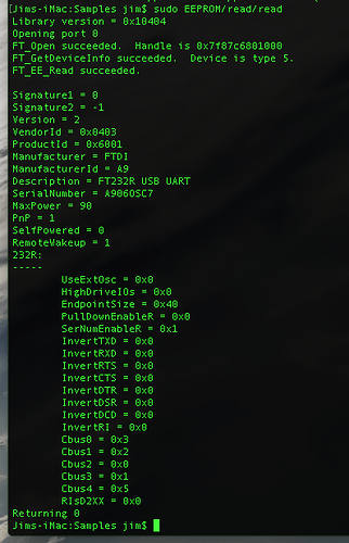

New to Arduino - looking forward to playing around with it and giving it a test drive.. but.. It doesn't seem to be working for me. I can't get USB to show up under TOOLS -> PORTS, only Bluetooth (see screenshot)
  • OS: Mac OS High Sierra 10.13.3
  • Arduino version 1.8.5
  • Arduino Nano (Genuine, ordered from arduino.cc)
It shows up in my Hardware --> USB as FT232R USB UART (see screen shot). I'm hoping that's a good thing. Hooked directly into the USB port on the back of the iMac.

I've tried:
  • 2 different USB cables, and ports.
  • rebooting
  • installed D2xx Helper - and 1.4.4 driver
  • $ sudo EEPROM/read/read (see screenshot)
  • re-downloading Arduino program
  • turned off Bluetooth on the Mac
  • Tried the Arduino web application (with plugin)
    - rebooted a few more times for good measure :o
Any suggestions/troubleshooting tips would be greatly appreciated!
