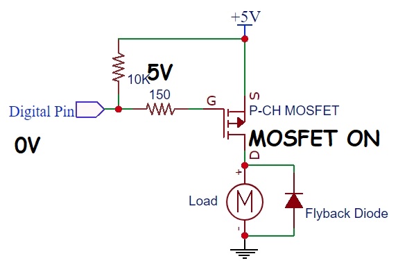

I would like to switch a 5V load using a 3V3 GPIO (I am using an ESP32 microcontroller if that's relevant). I've read quite a few posts on the forum about high-side switching and which PMOS to use. Several people said NDP6020P was one of the best/only options in through-hole for this type of application. I ordered a few on Amazon (not sure if they are real since the part is discontinued).
I am trying to implement the very basic circuit as follows:
Since my load is not inductive I omitted the flyback diode. For testing I used a LED +500R resistor as load. The 5V source is the 5V pin on the microcontroller.
My issue is that the LED stays on no matter what I set the GPIO to.

It seems as soon as I replace the user switch above with the GPIO of my ESP32, it doesn't work anymore.
I also tried measuring the Vgs in the first circuit when the GPIO is switching. I can see it moving between -4.8V and -1.5V depending on the state of the pin. << given that last result, I guess it is not surprising that my PMOS is always on, since -1.5V is above the VgsON of 0.7~1V. However, I don't really know where to go from there, i.e. make it go below the threshold voltage. Any help greatly appreciated!
If your's switching a load high-side, and the supply voltage for that load is higher than the logic voltage of the processor, then you need a level shifter between MCU and mosfet.
See the third diagram on this page.

Thank you both @runaway_pancake@Wawa. I will try adding a 2N3904 tomorrow. In the meantime, an additional question: I chose the NDP6020P because it had the ability to switch on 3V3 inputs. If I understand the role of the 2N3904, it allows me to essentially switch using 5V instead. I am wondering if there was a cheaper/easier to find through hole PMOS (or other high-side switching solution) that I could have used instead of the NDP6020P, and that would work equally well in combination with a 2N3904?

Even if you set the GPIO to INPUT, the mosfet may still stay on. That's because all processor GPIO pins have protection diodes installed between each GPIO pin and Vcc. If voltage on the pin rises above Vcc, the diode shunts it away, thus protecting the pin circuitry. But when you connect an external pullup resistor from that pin to a 5V rail, current flows through the protection diode to the 3.3V Vcc, which brings the voltage on the pin down to about 3.9V. And that's enough voltage difference to turn on the NDP6020P.
It's possible you could get it to work using a mosfet with a higher threshold voltage of something like 2V, but you would still have current flowing through the protection diode, which is generally discouraged, plus it would be wasting some of the power that you're trying to save. So anytime you're trying to switch a voltage higher than the chip's Vcc, it's best to use the two-stage circuit.

Assuming two Schottky diodes, the circuit would be something like this. However, the best solution is the one that you have now implemented with the NPN transistor.
I am not an expert in transistors, but as far as I understand, when the input is low, the transistor is an open switch, so 5V is connected to PMOS Gate through 10k+150k. (making V(gs)=0V?) When the input is high, the transistor acts as a wire shorting the midpoint between 10k and 150R to ground, pulling G to 0V and creating a V(gs) to trigger the PMOS. I might be wrong.
From schematic in post #3. when digital pin is high, 2N3904 is on, which pulls p-ch gate to 0V. VGS is voltage at gate minus source = 0v - 5v = -5v. -5v is below the threshold voltage, which turns mosfet on.
When digital pin is low, 2N3904 is off and gate of p-ch is pulled to +5V through the 10k pullup resistor. VGS = 5v - 5v = 0v. 0v is above the threshold voltage, so mosfet is off.
