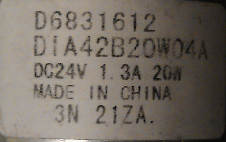

Neat little BLDCs with built-in controller.
I found some rather handy little 24V BLDC motors on eBay
http://www.ebay.co.uk/itm/DC-24V-20W-High-grade-brushless-motor-brushless-motor-with-encoder-PWM-speed-/261713199819
They do all the work for you, and provide a 400cpr incremental encoder too.
The no-load speed at 24V is 6400rpm, so at 20W they must be about 30mNm
or torque.
So I ordered on and when it arrived I sat down and implemented a Servo-loop to drive
it.
The interface is:
PWM signal (0% = full drive, 100% = no drive, note),
brake signal (active low),
direction signal.
And the quadrature encoder takes a 5V supply and gives AB outputs (no
pullups needed).
Here's my sketch:

Some photos:
And video: Servomotor test - YouTube
(and in slow-motion: Servomotor test - YouTube - it moves so fast its hard to tell its going 3/4 turn :slight_smile:

I have one of these motors but I can't seem to get it to work right. When I add power to the encoder the motor stops. Could you show a diagram or pic of how you wired it up, I can't tell from the photos or videos you posted. I have
Red +24V
Black Ground
Yellow +5V
White 15-25KHz pulse 80% from function generator
Green +5V
With just that the motor runs and controls OK via PWM
However as soon as I add +5V to Blue it comes to a stop
I have an arduino uno and I'll try that next if you can supply the wiring map that is working for you.
Thanks.
That agrees with the pinout for mine:
red - +24V
black - GND
yellow - brake (active low)
white - PWM (active low)
green - direction
blue - +5V for encoder
brown - encoder B output
orange - encoder A output
The encoder is separate circuitry sharing only the GND pin so you don't
need to supply 5V to run the motor - powering up the encoder shouldn't
have any effect on the motor.
Have you tried just powering the encoder (black/blue/brown/orange) and
seen if its working?
When you powered the blue wire did you remove 5V from the yellow (thats
brake signal)?
The encoder does work when I power it separately and turn the shaft by hand. I wired as you suggested leaving yellow disconnected and blue +5V . Thanks for that. That seems to work. How is the brake supposed to be actuated in practical use?
