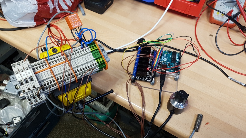

Hi all,
started from scratch almost (Basic stamp about 10+yrs ago minimal use) 2 days ago using the Uno board and writing code!!
After using a book for reference (Programming Arduino by Simon Monk) and the good old web for info and researching, im pretty happy with my build and coding so far.
But...
I've hit a brick wall and im looking for a fresh direction on code to try to solve the issue. :confused:
Question: How can i translate a numeric reading generated from my 'Rotary incremental Optical Encoder' to show rotational degrees (0-359 per revolution) in my sketch so that i can handle that better in my code?
As you can see in my sketch i get a signal count of 720 pulses per 360 degrees of the encoder (360ppr encoder, A+B inputs = 720).
I have set a reset for count = '0' if >719 so the count doesn't max out at 65535 and then back to 0 again which clearly is no use to me for the application. This gives me currently a 720ppr to handle in the code for my timings. '0' counted as a position so 719 max is 720 in real terms per revolution.
Although it works great at the moment it has a few failings in the use of the count and not actual degrees.
Issue:
If you rotate in reverse the outputs work fine as the count decreases but the value goes '0' and will not cycle to 719 and reduce again as it is a pulse count. This then affects '0' position (or TDC if you prefer) and has the affect of putting all timings out of the fixed datum position on the machine being TDC at a given fixed point in the machines cycle.
Result: All timings, all correct relative to each other but all out on the machine.
Solution: Translate count to rotational degrees, 0-359 to 0 again in one full forward revolution. Reverse encoder rotation shows 359-0 and 359 again. Modify required timings for outputs in 0-359 range in code.
###Sketch as follows### (first post so probably attached sketch incorrectly..sorry)

With 720 pulses per one 360 degree rotation each pulse is .5 degrees and + and - would just be direction of rotation.
Some math could be used to determine zero crossing.
Such as the encoder is at +2 degrees and it is to be sent to 358 degrees, would be a - directional rotation of 8 pulses from its current location.
Or you could forget about using a absolute reference and, instead, use a relative reference. Upon start up allow the encoder to find the first .5 degree point it comes upon and declare that point as zero. From there rotations are just a matter of counting +/-.5 degree pulses and keeping track of the current position.
Yeah the .5 degrees is not an issue and gives a higher 'degree' (no pun intended) of timing.
The later suggestion wont work for the application though as the timings are relative to the machine position so the position or reference would need to be the same as when powered off. when you power back on it naturally defaults the count to '0' as its had no pulses as yet. the machine may of turned off at any value other than '0' so timings would be out unless a 1 in 720 chance it was switched off in position '0' on the counter. clearly not good.
But... zero crossing would be a solution! how do you code that??
That would give a virtual 'position of degrees' in an acceptable format of 720 pulse (positions) per physical revolution.

Hi dmaintenance
to get the counter issue overflowing properly, I'd do a couple of things
first off, as far as I can see, counter does not need to the an unsigned int. Make it an ordinary int.
you can then do the rollover in both of your interrupts, eg:

you can now divide count by 2 to get your 0 .. 359 range. However... You're only doing something in your code every second tick. So what's the point of counting every tick? Just increment/decrement your count each time you're going to to actually do something. This will, by default, give you a range of 0..356
thanks darrob. that pushed me along a bit. Not sure if entered in correctly tho as it worked in 2 ways, neither 100%.
I pasted your much appreciated code in to my sketch and it maxed at 719 and started at '0' again as before but this time when in reverse past '0' it scrolled brilliantly decreasing but from 65535.
So i duplicated your sample code in to both parts of the sketch as follows thinking thats what i should of done in the first place and it hangs at 65535 when you reverse like before.

only the first interrupt running now as in code relating to Input A. It makes the value max out at 359!! Brilliant.
And not sure why still shows direction as in decreasing value in reverse. Thought i needed A+B for that?
So... the only issue at this pint is the fact that it scrolls down past '0' as before decreasing but from 65535.
Being that your simple code has achieved so much im thinking this issue is simple enough also?
Feels like jumping hurdles!!
Hi dmaintenance
The reason the the code start counting down from 65535 is because you have declared count as unsigned int. [0 .. 65535] at the top of your code. It does not need to be. As I pointed out in my previous post, declare count as int [-32766 .. 32767] this will make the reverse direction flip back to 719 once you go past 0
as to your code, double check what you have done in void a1(). You appear to have the reset logic reversed
If you really need to have count as an unsigned in, then do a check (when rotating in the reverse direction) for when count hits 65535 and reset count to 719

"constrain"!!! wow the solution finally.
 Serial.println (counter);
 counter = constrain (counter, 0, 719);
scrolls up to 719 and then starts at '0' again.

I'm almost complete but i still keep getting inconsistent readings from my brand new optical rotary encoder, that is verified with the scope as ok and functioning as it should. I also wired a higher quality brand new OMRON encoder to see if spec was an issue (same 360ppr) and no change.
I've installed fastRead/Write etc that im sure helps but has no effect just in case the code is getting slow looping.
Running on an UNO, tried on my bench Mega with fastRead removed as it didn't work and presume it was written for the different chip with different configuration. Same issue with the variation in the encoder 'counter' value though.
I have now installed Bounce2 and it appears better, but not 100% solved the issue.
I have an '0' position reset installed to help keep the 'TDC' in check but really i shouldn't need this after the first cycle to set '0' and then let the encoder values maintain this correctly.
Its a work around using reset value every 360 degrees but would rather fix the issue and learn from it.
I'm not sure if the bounce code is correct as i hoped this would finally sort any 'ghost' signals from the encoder (if thats the issue, still think its bad code). I noticed on the scope the minutest of steps in the signal 'Raising' from LOW. I really clutching at straws as its so small and rare i dint think its the issue causing the variable reads.
When i say variable, inconsistent, i mean if i rotate slowly or quickly by hand the encoder shaft (fitted with control knob with arrow for test purposes only) 360 degrees to best by my eye to a preset mark on the encoder body, some times the value is '0' every time, then randomly it will drift up or down by as many as 5 degrees value. The more you do it without the '0' reset feature the more it drifts out.
I have tried many variations with RAISING, FALLING, CHANGE, HIGH or LOW but some settings don't work or some with no improvement.
I have thought maybe im asking too much from an UNO but my gut feeling is a problem with the code.
The UNO can do so much more than blink LED's but i don't know as yet its limits. You guys would be able to advise me of that im sure??
I've used the interrupts so the 'counter' value from the encoder should be reliable in my mind and if anything the outputs would be an issue with lag. I've even tested with a small drill on the encoder to spin at high revs and the outputs work fabulously. The OLED screen showing each output struggles at high speed but thats just for my reference purposes at low speed so all fine there.
Is the Bounce code working is my thought?? (i still don't think i should need it for an optical digital encoder)

Hi dmaintenance
I think one of the major problems is that you've got interrupts on both pulses,
You're counting 720 pulses per complete rotation.
Output A (which is the one to count) will pulse 360 times per rotation (hence the name of your device, LPD3806-360BM-G5-24C 360PPR)
Output B is always 90 degrees out of phase output A. This output should only used to determine the direction of travel.
You look at the status of Output B on the falling edge of Output A to get the direction.
I am also pretty certain that counting both pulses becomes an issue when reversing direction.
I don't have a device to test or an oscilloscope/logic analyser, but I would love to see the waveforms of Output A and Output B when you change direction. I'm pretty certain that Output B will stay at one level for a complete period of Output A, which in turn will throw your count out.
So I think you should leave this in your code, (but change from RISING to FALLING)

You should not need an ISR for OutputB
Post the specs on the encoder, on at least a model number. You've eluded to A and B outputs which suggests it a quadrature encoder and if so, you're going about this the wrong way.
DKWatson:
The encoder is LPD3806-360BM-G5-24C 360PPR (from the first post)
Similar to this one Incremental, 2 phase
Hi darrob,
yeah i get what you say about 360ppr and 2x inputs gives 720 which is not needed for the counter but if you run it without the InputB the value naturally halves to 360ppr but you loose the reverse detection function.
If the machine for example was to stop and mechanically increment back slightly it would not reduce the count accordingly. Mechanical resistance from a cam up-slope for example.
It would give you the other issue of incrementing the count up when going in reverse. Gave it try and worse than current setup.
Both inputs are needed and have the interrupt so they always register the value as they are the most important part as all other code is defined from an accurate counter value scrolling reliably mostly in forward rotation but in reverse just to register any slight reverse movement when coming to a halt on the machine.
if you scroll down on the page from the link above they have a diagram/image explaining how the pulse phases give the information of direction. They use a basic encoder but i couldn't jump on a better image quicker. same principle requiring 2 signals for direction.
My mind is leaning towards the ++ and -- code but it works and without it doesn't.
still pondering and scratching my head about it.

// Encoder outputs for counter
 void ai0() {
    // ai0 is activated if DigitalPin(2) is going from LOW to HIGH
    // Check pin(3) to determine the direction
 if(digitalRead(3)==LOW) {
      if (bouncer.update() && bouncer.read() == LOW);
        int counterValue = LOW;
        counterValue = ! counterValue;
        digitalWrite(inputPinA, counterValue);
      counter++;
      if (counter > 719)      //counter roll over to '0'
        counter = 0;
    else {
      counter--;
      if (counter < 0)        //counter roll back to '719'
        counter = 719;
  void ai1() {
  // ai0 is activated if DigitalPin(3) is going from LOW to HIGH
  // Check with pin(2) to determine the direction
  if(digitalRead(2)==LOW) {
        digitalWrite(inputPinB, counterValue);
      counter--;
   }else{
      counter++;
// SSR outputs for machine
  if (counter < ssr1_start) digitalWriteFast(5, LOW);{
  if ((firstCycle == 1) && (counter > ssr1_start) && (counter < ssr1_end)) digitalWriteFast(5, HIGH);{
  if (counter > ssr1_end) digitalWriteFast(5, LOW);{
  if (counter < ssr2_start) digitalWriteFast(6, LOW);{
  if ((firstCycle == 1) && (counter > ssr2_start) && (counter < ssr2_end)) digitalWriteFast(6, HIGH);{
  if (counter > ssr2_end) digitalWriteFast(6, LOW);{
  if (counter < ssr3_start) digitalWriteFast(7, LOW);{
  if ((firstCycle == 1) && (counter > ssr3_start) && (counter < ssr3_end)) digitalWriteFast(7, HIGH);{
  if (counter > ssr3_end) digitalWriteFast(7, LOW);{
  if (counter < ssr4_start) digitalWriteFast(8, LOW);{
  if ((firstCycle == 1) && (counter > ssr4_start) && (counter < ssr4_end)) digitalWriteFast(8, HIGH);{
  if (counter > ssr4_end) digitalWriteFast(8, LOW);{
  if (counter < ssr5_start) digitalWriteFast(9, LOW);{
  if ((firstCycle == 1) && (counter > ssr5_start) && (counter < ssr5_end)) digitalWriteFast(9, HIGH);{
  if (counter > ssr5_end) digitalWriteFast(9, LOW);{
  if (counter < potValue2) digitalWriteFast(10, LOW);{
  if ((firstCycle == 1) && (digitalRead(5)== LOW) && (counter > potValue2) && (counter < potValue)) digitalWriteFast(10, HIGH);{
  if (counter > potValue) digitalWriteFast(10, LOW);{
  if (counter < ssr7_start) digitalWriteFast(11, LOW);{
  if ((firstCycle == 1) && (counter > ssr7_start) && (counter < ssr7_end)) digitalWriteFast(11, HIGH);{
  if (counter > ssr7_end) digitalWriteFast(11, LOW);{
  if (counter < ssr8_start) digitalWriteFast(12, LOW);{
  if ((firstCycle == 1) && (counter > ssr8_start) && (counter < ssr8_end)) digitalWriteFast(12, HIGH);{
  if (counter > ssr8_end) digitalWriteFast(12, LOW);{
dmaintenance:
Hi darrob,
it's not quite how th encoder is supposed to work, but if you're going to count both phases, you will need to implement the rollover on InputB as well
  void ai1() {
      if (counter == 0)
        counter = 720;
      counter--;
   }else{
      counter++;
      if (counter == 720)
        counter = 0;
Leave the rest of your sketch as it ws, but just change the ISR for InputB
As I say, I would love to look at the output of one of these when the direction actually changes, I'm sure that there will be a discrepancy in the counts.
