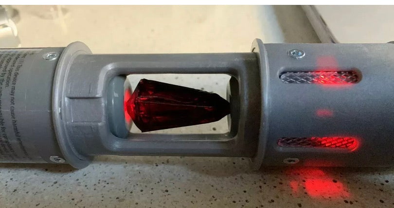

Here's an example of how I'd like it to look with the LED's lighting up the crystals, just I'd put a little slot for the Kyber Crystal to go:

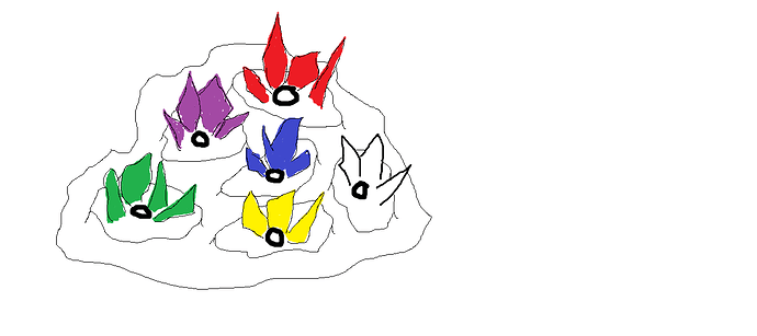

The idea would be, it would be a bigger "rock" with 6 big openings for 6 different crystal "clusters." What I thought would be really cool to try and do would be use the RFID chip that's already inside the Kyber Crystals to determine what LED color shines. Similar to how the lightsabers that you use the crystals in have a reader in them to tell the lightsaber what color to be. (Red, Blue, Green, etc.) So, technically, if you have an RFID reader/programmer, you can reprogram any crystal to be any color. (i.e. you can turn that Red crystal into a Green crystal by giving it a new RFID tag number.)
It'd be awesome if I could attach a micro RFID reader inside the base of each crystal cluster slot that could read each specific Kyber Crystal when it's placed into it's holder. Then, depending on it's specific code, it would tell that LED what color to shine. Also, if there is no Kyber Crystal in the cluster, it would shut that LED off. That way I could just make all of the crystal clusters the same semi-transparent clear material, which would make printing them a heck of a lot easier/cheaper. As well as be able to use the same Arduino code for each of the 6 crystals clusters.

Well, that's part of my problem. I don't really have the experience to know what's out there. I was just kind of going off of what Disney used for their Lightsabers. They have some kind of RFID reader on one of their boards and a small coil at the base of the slot you put the crystal into that reads the chip and tells the LED what color to be.
I was hoping I could kind of take that same setup/design and basically recreate it 6 times, 1 for each different color, and have 6 slots to place the crystals that illuminate whatever color the crystal was. I wasn't sure if an Arduino UNO could do 6 different readers at the same time though. Maybe using something like a couple of these:

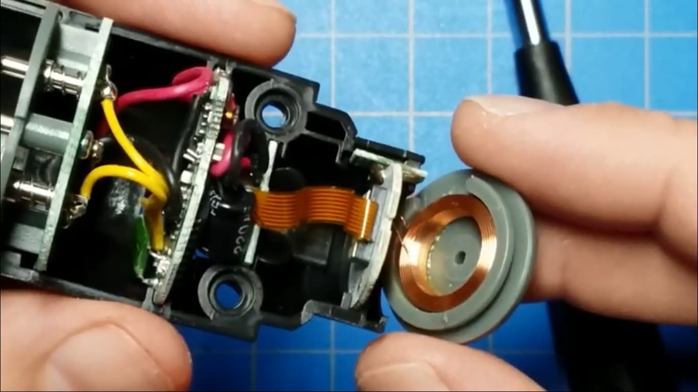

After doing a little more research, it looks like the RFID chips inside all the Disney crystals and custom Etsy crystals are EM4305 chips that operate at a 125kHz frequency. So, I'd have to find a low frequency, short range, 125kHz reader that reads EM4305 chips. I feel like I'm at least getting somewhere. Haha.

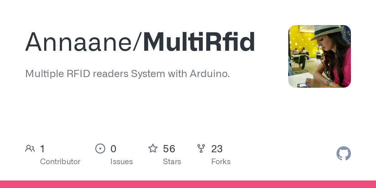

I was able to find this post from a couple of years ago where she hooked up 4 RFID readers to 1 Arduino UNO for an Escape Room puzzle. You would need to place the card tags on all the readers at the same time to open the door. She also says in her Youtube video that she only installed 4 in the video because she was in a hurry, but that she could install up to 6 readers on the 1 Arduino UNO board.
So, it looks like it's possible to attach 6 RFID readers onto 1 Arduino UNO board. I would just need to find the appropriate reader that can read those specific 125kHz EM4305 chips. Then figure out what kind of code I would need to recognize the assigned tag numbers and assign RGB color values to output that matching color.
Also, in the Youtube video, the RFID readers she was using were only a couple inches away from each other and didn't seem to have any problems with detecting only a single card. I think this could actually work. Wooo!

A couple of inches for those cards which integrate the coil, is probably OK, particularly if the tag will be exactly parallel to it.
The common request here is for a reader which will detect tags up to a foot away (or even more!), requiring a large coil at least. Your requirement is the very opposite. :grin:

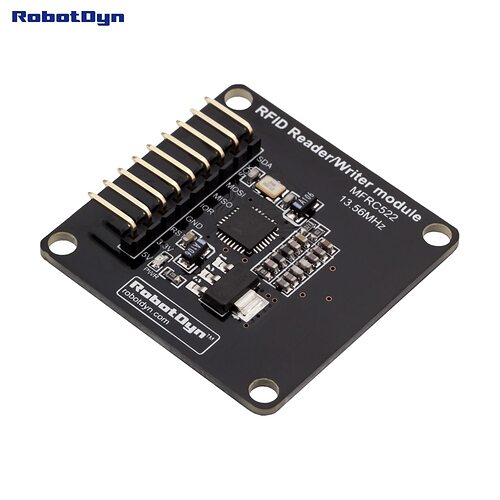

One thing I've been curious about though is if I get something like this:
https://www.ebay.com/itm/324737040405?_trkparms=ispr%3D1&hash=item4b9bd60015:g:vbAAAOSwJ6tfAaVW&amdata=enc%3AAQAGAAAA4PBAQdZekoSkbcrI1oBZyIol5yCo2XStV2ysS6Fbb0OuzxtiXGa%2FJ5%2BIQo8hhhXcvvIqjKhleNAYZGKncqliHaGnmnGkzTe6iHshT2BizlX4LYu1ShfqhWyMlTrxbJU0gO2%2BDCjEk%2B9dDZYDErS5RYO4PkYJIvkr5Hzz2HSqBDts6e778zX6whjkbuItdQe4I2R2IdETO7jSAvZlXXR947QnhUAJNokgUzyiJ5lqvyXVhylO5Hv0W8BhQ%2FH6XniXRekJjPJPJz%2Bhonl%2BhrGH3fT9Y7p%2FCAy%2FbUfFoahjSgEG|tkp%3ABFBMjtaXirpf
Are these wired antennas able to be modified at all? Like, could I unwind it and then rewind it so that it was a smaller circle? Something that wasn't such a large rectangular shape? I don't see why it wouldn't work, but I wasn't sure if that specific shape was designed a certain way for the radio waves or something? Some of the cards have circular wires and others have big rectangle wires. Not sure if the shapes of the antenna matter or if it just needs to be wrapped in a certain direction. I guess they're only $6, so I could always just get one and try it out.
And the larger the coil, the higher the price. This is commonly referred to as a "J-curve".
Only if you have the necessary instrumentation to measure its inductance before and after you make the modification. You may (will) need longer or shorter wire - I can't quite recall which.
This is because it combines with the capacitors on the PCB to form a circuit tuned to the operating frequency. It may be possible to change the capacitors, but you would still need instrumentation of some sort.
