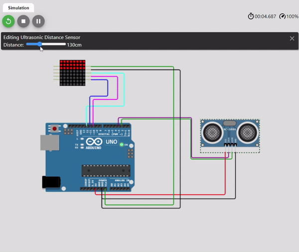

I have built two Arduino projects using an LED matrix (MAX7219). I need help and guidance on connecting two projects to a single UNO.
Task1:
By varying ultrasonic range from 0 to 400, rows from 0 to 7 of LED matrix will glow.

Task2:
By adjusting potentiometer, 2 panels of LED matrix will light up row wise.
POT value 0 to 512 - panel 1 will light up
POT value 512 to 1023 - panel 2 will light up

Here in this projects, I have used different panels of MAX7219.
The code you posted for both tasks is incomplete.
Post your attempt to combine them and explain what the problems are.
Hi Paul,
Thanks for the reply.
FYI, I got output for both tasks. I want to connect them in single UNO, but I have no idea how to combine them
You need to merge the 2 codes into a single code which achieves whatever pattern of LEDs you need.
It's hard for anyone to help with more detail because you have not made it clear how you want to make the led patterns. How many 8x8 panels will your project use? How will the pattern of LEDs look as the pot and distance sensor values change? Your attempt to explain that is very ambiguous.
Totally 3 8x8 panels will be used. 1 panel for task1 and the remaining panels for task2.
Task1: If I vary the ultrasonic range from 0 to 400cm, LED matrix will start to light up from row 0 to row 7
ultrasonicwithLEDmatrix-WokwiESP32STM32ArduinoSimulator2-ezgif.com-video-to-gif-converter
Task2: Using Potentiometer
Value range from 512 to 0 - panel 1 will glow like row 0 to row 7
Value range from 512 to 1024 - panel 2, row 0 to row 7
ledmatrix-WokwiESP32STM32ArduinoSimulator2-ezgif.com-video-to-gif-converter
Hope I explained in detail.
Ok, that's somewhat clearer. Should be quite straight-forward I think.
Have you thought how you will connect 3 panels to same Arduino? The easiest way should be to chain them together, I think.
