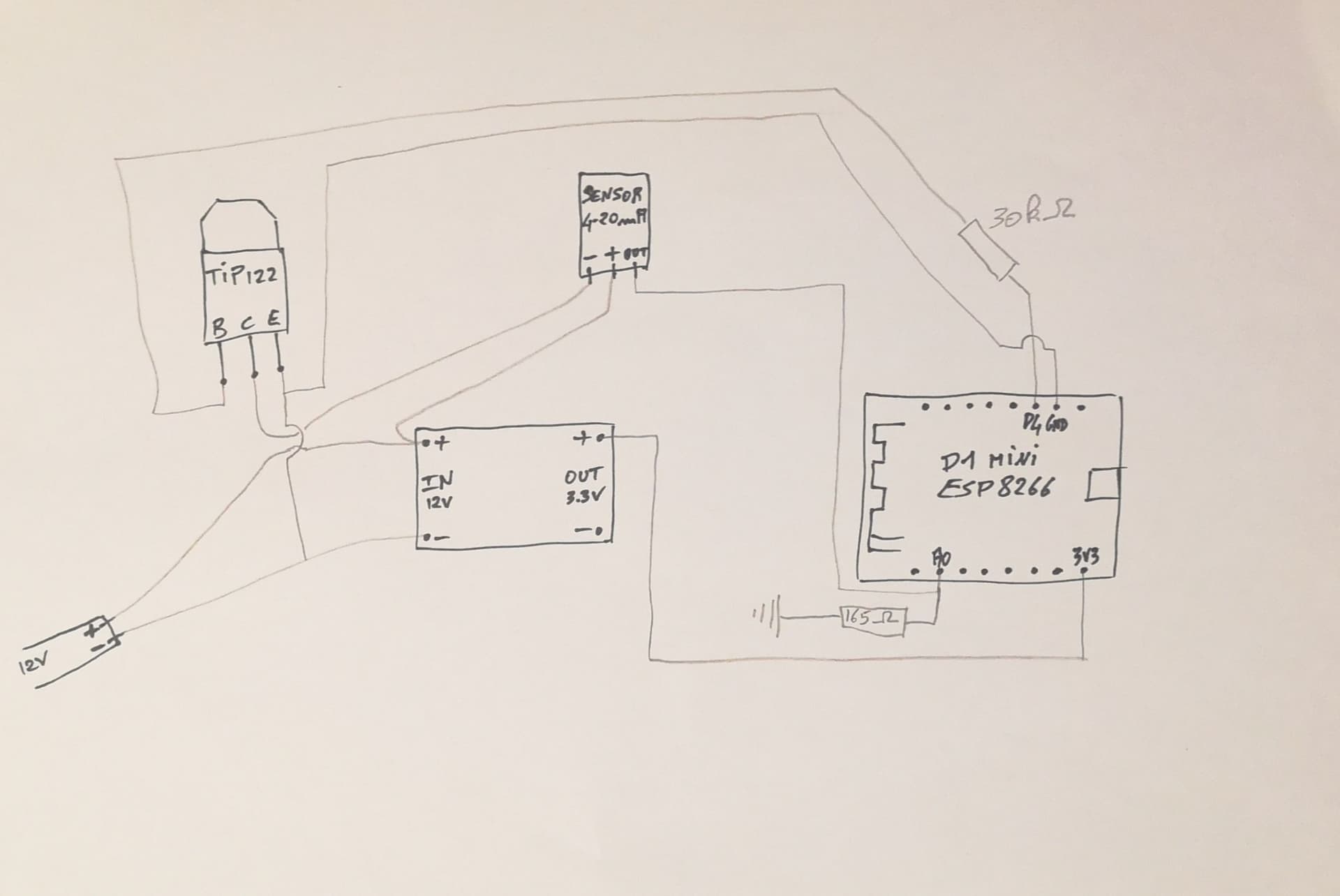

Thanks again @gilshultz, @mrburnette and @DrDiettrich for your suggestions. I read this Arduino cookbook, a couple of articles and watched a few videos and I'm a bit more confident now.
I came up with a schematic, I tried it and it's working fine. The only MOSFET I received at the moment is the TIP122. I will receive the IRF520 and others later.
My question is this one. My sketch goes to deep sleep between each measurement but the current is still 15mA during this period. There must have a way to optimize it. Could you please tell me how?
As a reminder, I'm using the mini D1 esp8266 (I'm planning to switch to esp32 soon, maybe I should use it here?!). My sensor is a piezometer (4-20mA) which requires a pull down resistor of 165 ohm. This part is correct as I tested it before. The problem should be more around the MOSFET. I calculated the value of the base resistor as shown here:
And this is my schematic :
Thank you in advance for your help
Find the impact of the sensor by manually connecting and cutting the Gnd connection. You can do this with only the sensor and resistor. I'd think that turning off the Gnd is not the right way to preserve power, you better turn off Vcc (+).
BTW TIP122 is a Darlington BJT with considerable voltage drop. A MOSFET will switch better but this may not be significant right now.

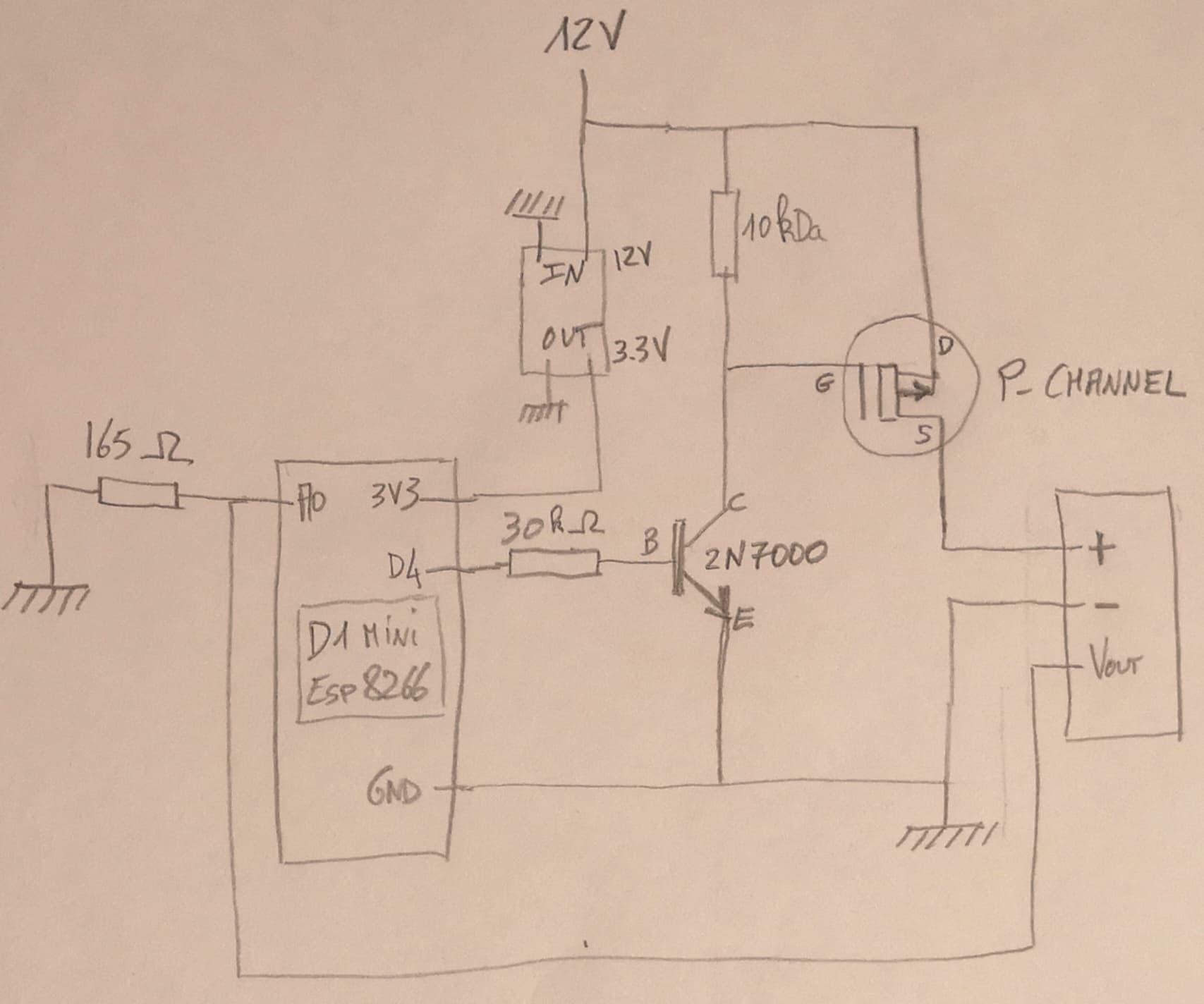

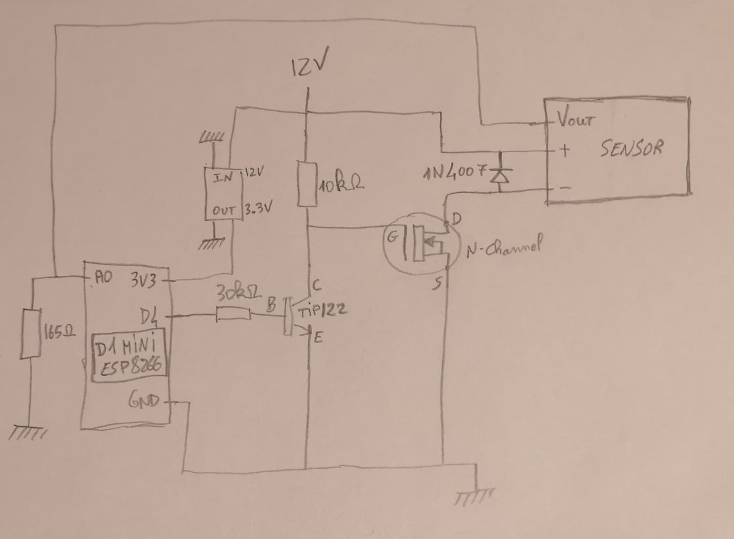

So I read more and following your advices, I came up with this schematic. I don't have any P-channel so I decided to go with the N-channel. I have in stock: IRLZ44N, FQP30N06L, IRLB8721, 2N7000. Plus, I read this:
Still, I will order a P-channel MOSFET. Would the IRF9540N be appropriated for this?
Before I burn something, can you please check if I did something wrong.
Did you mean to replace the TIP122 by the 2N7000?
I also put a diode for the sensor. I saw that somewhere. Hope it's ok.
Does it make any sense? Should I call the firemen first?
Thanks
Yes, before the sensor sends 12V to the controller input. With a high side switch this can not happen.
You can call the fireman but it will be a very small one. You can do this but the sensor will probably feedback 12V to your A0 input blowing the port. Stay with the high side switching, switching the ground (-) can lead to backfeed problems.
A simple rule P (P-Channel) is for Positive and N (N-Channel) is for Negative.
Try the 2N7000 in place of the TIP122 it will probably work but you need a P-channel MOSFET on the +12V. Since there is nothing inductive in your sensor the diode is not needed.

So is it better this way?
Now, I'm not sure for the value of the pull-down resistor at 30k.
Do you think an IRF9540N would be fine?
Thank you
It looks great. The turn off of the MOSFET will be slow because of the gate capacitance. You might want to make it in the 5-10K range. It will still be a little slow but ok. Your schematics are getting better, keep at it.
