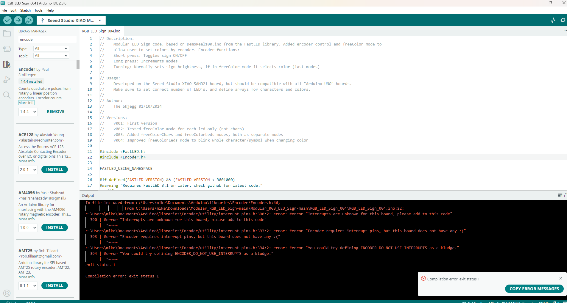

@comet424 please always provide error output as text. Providing pictures of text is very unhelpful!
Arduino IDE even makes it very easy for you to get the text: just click that nice "COPY ERROR MESSAGES", then paste the copied error message into a reply on the forum topic.
You can learn how to correctly use Arduino Forum by reading this guide:
here is the error
sorry
In file included from c:\Users\mike\Documents\Arduino\libraries\Encoder/Encoder.h:46,
from C:\Users\mike\Downloads\Modular_RGB_LED_Sign-main\Modular_RGB_LED_Sign-main\RGB_LED_Sign_004\RGB_LED_Sign_004.ino:22:
c:\Users\mike\Documents\Arduino\libraries\Encoder/utility/interrupt_pins.h:390:2: error: #error "Interrupts are unknown for this board, please add to this code"
390 | #error "Interrupts are unknown for this board, please add to this code"
c:\Users\mike\Documents\Arduino\libraries\Encoder/utility/interrupt_pins.h:393:2: error: #error "Encoder requires interrupt pins, but this board does not have any :("
393 | #error "Encoder requires interrupt pins, but this board does not have any :("
c:\Users\mike\Documents\Arduino\libraries\Encoder/utility/interrupt_pins.h:394:2: error: #error "You could try defining ENCODER_DO_NOT_USE_INTERRUPTS as a kludge."
394 | #error "You could try defining ENCODER_DO_NOT_USE_INTERRUPTS as a kludge."
exit status 1
Compilation error: exit status 1
Please tell us exactly which Seeed board hardware you own. The tutorial specifies the use of the Seeed Studio XIAO SAMD21 board:
https://www.printables.com/model/1148094-modular-rgb-led-sign-version-2#:~:text=fill%20pattern%3A%20Gyroid-,Parts%20needed%3A,-Seedstudio%20XIAO%20SAMD21
Parts needed:
  • Seedstudio XIAO SAMD21 microcontroller
You have configured Arduino IDE to use the "Seeed Studio XIAO MG24 (Sense)" board. Despite the similar name, that is completely different hardware from the XIAO SAMD21 board.
If you actually own the XIAO SAMD21 board, then the solution will be to correctly configure Arduino IDE for use with the board you actually own.
If you do truly own the Seeed Studio XIAO MG24 board, then it will be necessary to take some measures to port the tutorial that was written for use with the XIAO SAMD21 to work with the XIAO MG24.

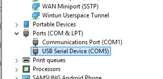

so its getting closer lol.. but got another error it wont upload it uploads some of the code as it makes a drive letter and adds a index.htm and info_uf2.txt files
the error is
Sketch uses 42548 bytes (16%) of program storage space. Maximum is 262144 bytes.
No device found on COM5
Failed uploading: uploading error: exit status 1
the htm file takes me to the raspberry pi site
and the txt file has
UF2 Bootloader v3.0
Model: Raspberry Pi RP2
Board-ID: RPI-RP2
going to re read all the steps to see if something else i must have missed a step
so i re read things i did it all right but it doesnt tell you what it should look like in windows device manager they show example of /dev/usbmodem in there arduino ide
what should the device manager should look like as i have it connected on com5

i havent soldered anything as i didnt wanna solder anything if i couldnt get the code to upload.. so far still cant upload it just fails
when it compiles to upload it then i guess reboots the module the com port goes away and it mounts so u have those 2 files…. when you unplug and plug back in it goes back to flashing red and blue so it never uploaded hte code.. and it goes back to com port 5..
so so far i am farther then i was but cant upload.. and the read board info just shows up unknown
