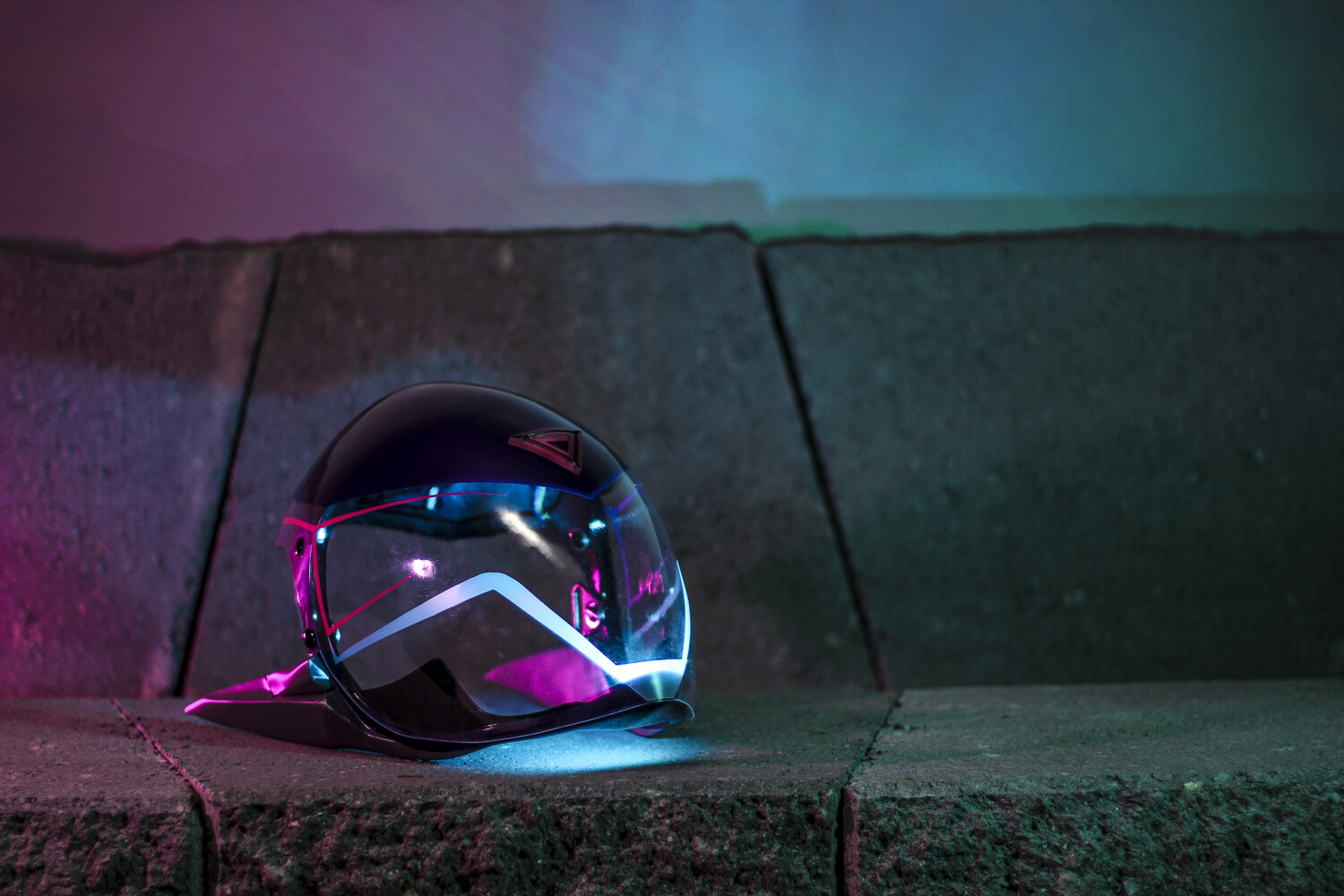

I'm starting a project and i'll need an Arduino to control the LED's
I have a picture with all the materials ( I only know the Arduino, the LED panels and the batteries ) but i'm confused about the rest, can you guys help me out ? Thanks ! ^^
The result of a quick Google reverse image search:
Powered by an Arduino Uno and an Adafruit Trinket, the electronics are housed in a discrete enclosed backpack. For temperature control, a fan is located under the chin.
They feature:
  • 8x static blue and amber 16x8 LED matrices and 1x 16x8 matrix, on Adafruit LED matrix backpacks. Each matrix is individually controllable and addressable via I2C.
    -The single 16x8 matrix has 5 toggleable emote images controlled by 5 discrete momentary switches located at each finger tip.
  • Electroluminescent panels in both cheeks as well as EL wire running across each ear.
What do you want to know exactly? What do you want to build?
