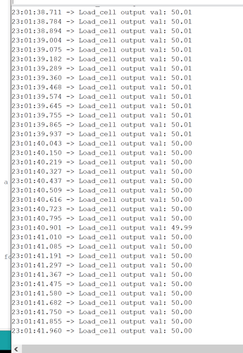

What I am noticing is that when I set an object on the scale, it "ramps up" to the value, and then when I remove it, it "ramps down". This is a problem because the way my code is set up as soon as the value is over 100 grains, it captures that value as the weight. But the scale is only then on its way up to the real weight.
You can see the output of my code from Serial Monitor here:
You can see that when I set an object on the scale, it first reports as too light, and then when it gets inside the OK range it reads as OK.
I tried to built a "stabilization" factor in but I don't think it's working. I basically said if the absolute value of the previous weight - the current weight is > .25 grains then keep weighing. But even if it worked right this is still a poor solution because the weight could be off by .25 grains.
What I'd like is a way to get the final, stabilized weight of the object in between zero conditions.

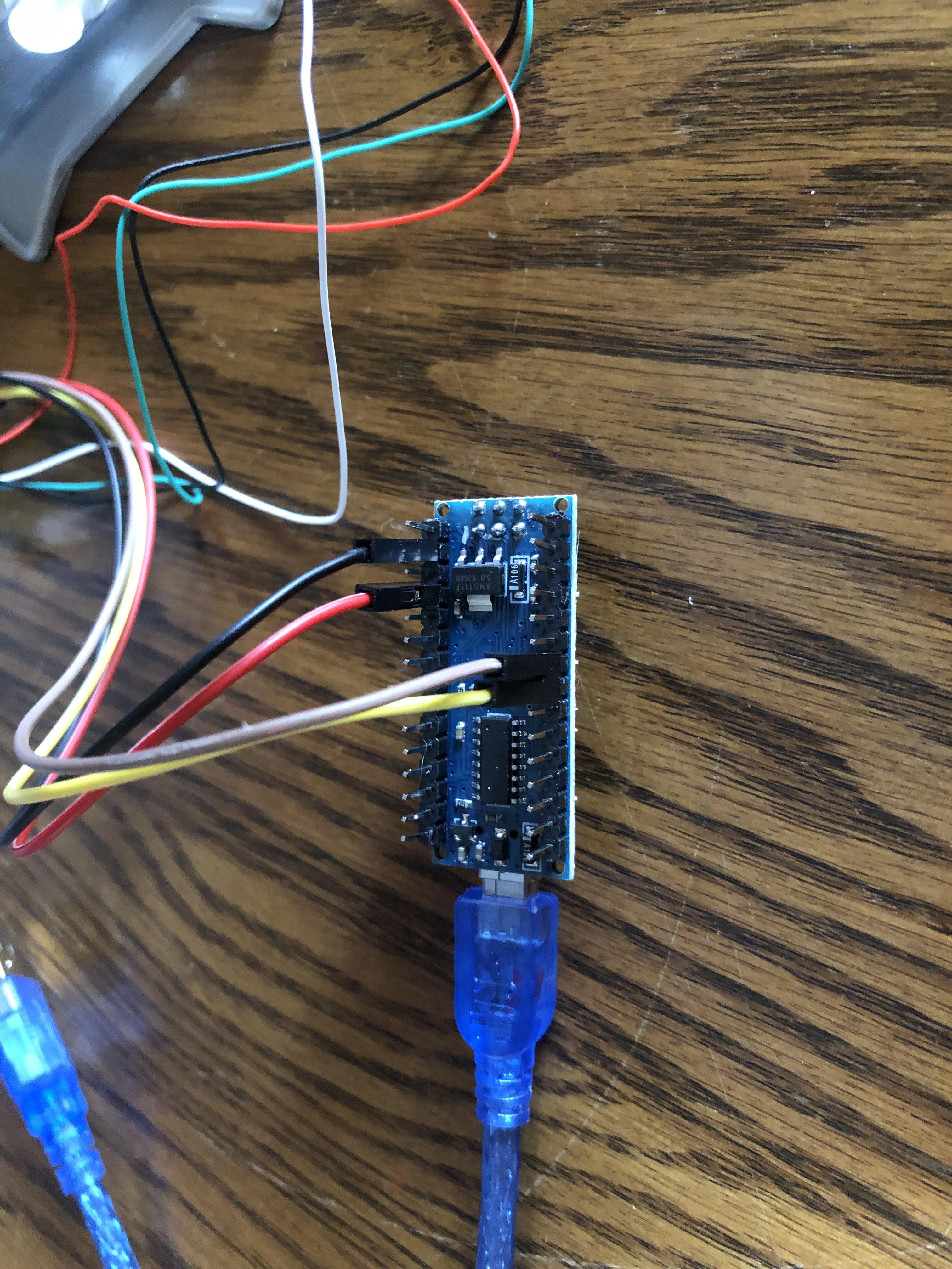

Here is my schematic:
Here is a picture of the Nano:

Add (solder) a wire between E- and the HX711 ground pin.
Leo..
You must fix that first.
From what I am reading, this is not necessarily required. Is there something in my output that makes you think it is? I am getting valid results from the scale. My problem is not reading the scale, it is figuring out when the weight has stabilized.
I can't see why any soldering is required.
The load cell presents itself as a Wheatstone bridge that receives a voltage on the E-/E+ terminals and any variation at the A+/A- terminals is measured by the ADC in the HX-711. No grounding is required here. No continuity between E- and ground is expected.
Just make sure the resistance between any two of the load cell cables is either 1KΩ or 750Ω when disconnected from the HX-711
The HX-711 will measure voltage variations on A+/A- in the millivolt range. This is very susceptible to electrical interference. Most of the time variations are a result of electrical noise.
Try to isolate the cables that connect the load cell to the rest of the circuit. You can twist them and also put some shielding insulation (such as aluminum foil). For instance look at https://electricalbaba.com/how-twisting-the-cables-reduce-the-interference/.
Standard Ethernet twisted-pair cable can also help.
Should I twist all 4 wires together or should they be in pairs? If pairs, which 2 should be paired?
I have twisted black+red and white+green in pairs.
Try moving the cell (and so its cables) away from the rest of the circuit.
As recommended above, filtering capacitors also help.
I'm afraid I don't know anything about electronics so modifying the circuitry is beyond what I am able to do.
I tried twisting all 4 wires together and covering them with aluminum foil. I had been trying a different HX711 library and could not get it to work so I have come back to the original library, and now I'm getting bizzare results on calibration. So it's all borked up now.
OK, I have twisted the red and black together, and the white and green together.
Calibration routine is running again with good values. Not sure what made it start working, but this is what the output typically looks like in Serial Monitor:
Weight is stable to within .01 grams. But as you can see it does jump around, reading about 10-15times as 50.00 and then a dozen or so times as 50.01. One time it read as 49.99 in this capture.
I'm guessing this is as good as it gets.
