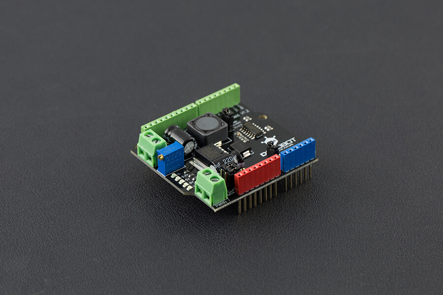

Could I use this as well?
Or do I really have to use a robot shield?
And if I really have to; Can I put two robot shields (2 x 2 motors) onto eachother?
Kind regards,
Willem
yes you can use this driver too ,its even better.
Hoi Willem, en welkom.
I don't agree with ksty, when he tells you that power shield is better.
The power shield is a power supply, not a motor control board.
You can control it with your Arduino, but only to switch it on or off.
You can also read the output voltage, but you can't control that voltage by your Arduino.
Also, you can't control polarity.
You can do all of the mentioned things with a motor shield, except direct reading an output voltage from the shield (you'd need to add something yourself for that).
Then again, you'll learn soon that voltage isn't that interesting (but current is).
It is very unlikely you can stack motor shields (their cooling profiles will not allow that).
And the boards ksty linked to aren't shields, and therefore aren't built to be stacked anyway.
You could use two of them, though.
Just need to have enough pins available.
