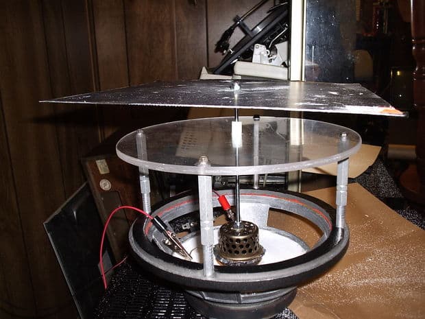

I made a project for my design studies. It is a kind of a electric Chlandi Plate which must work as a time indicator (another words - a clock)
(picture from Instructables)
I made my generator, but stuck on programming an Arduino. Please, help my to made a program!

I need a device to command a mechanical plate driver.
so, it must produce 12 different sound frequencies. Every frequency must change in some minutes, AND has an option to change "manually", by pressing a key. Every frequency must have a "unique" colour-combination of the LEDs (this LEDs are lighten the plate).
