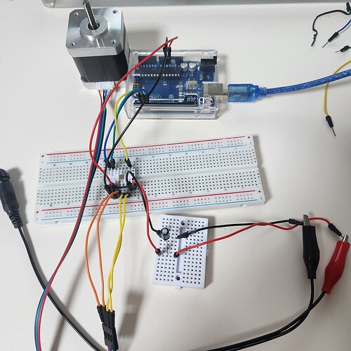

Hi. I connected it like the picture, but the motor doesn't work. It doesn't even vibrate and it doesn't work at all.
I used Nema17(17HS8401) and tmc2208. I used a 12V 3A adapter for the motor and connected to the computer with a usb port for the Arduino board.
It's a reference image.
DIR = 4 pin
STEP = 3 pin
EN = 2 pin
M2B = red
M2A = blue
M1A = green
M1B = black
I used 25V 100uf capacitor. The driver current was adjusted to 1.4amps

I can't tell from the photo, but do you have the motor coil pairs identified correctly?
The stepping rate is very high, might be to high. Make the step pulse high some 50 microseconds long and the delay to the next pulse 50 ms. When the motor rotates, trim the 50 ms down.
Where is the Logic Power Supply?
I used the multimeter to check the coil pair. I think they are connected correctly
After adjusting the stepping rate, the motor rotates. But it doesn't keep rotating in one direction, it keeps changing direction.

It changes direction randomly without a certain rule.
Sounds like an open input somewhere. Please post schematics. Pen and paper usualky works. Remember pin names, power suplis etc.
Maybe check that the coils aren't crossed?

I meant that one should check that your actual motor coil wiring matches your driver's actual connections. It's sometimes hard to tell by assumptions about the labeling, coloring, or ordering.
Is this a 4- or a 6-wire stepper? All steppers I came across so far with these 6-pin connectors and no centre tap of the coils ( 4 wire steppers ) are wired with crossover pattern. And that fits to this page of the used 17HS8401 motor. But of course there may be others too.
In any case it's always a good idea to check the wiring with a meter. And @ryohi_hyo already told us that he did so.
So I don't think that is the problem. And this type of wiring error usually leads to not changing the direction at all. @ryohi_hyo wrote it is changing randomly - which is a bit odd. Maybe there's a loose connection somewhere... :thinking:

It works fine after reconnecting. The only thing that has changed is the heat sink attached to the driver. Maybe there's a loose connection...
