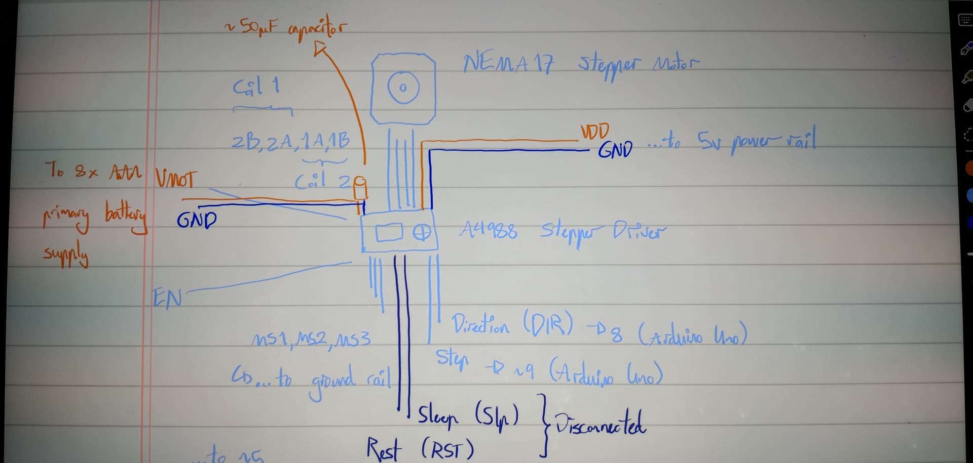

I'm trying to control a NEMA17 stepper motor using two buttons, a rotary encoder and an A4988 stepper motor driver using the following code:

The motor doesn't operate, and the serial monitor constantly outputs the distance to go as 0. What do I do??
@sofanthiel Welcome to the forum.
However, you might want to look at this How to get the best out of this forum before you proceed any further.
We only know what you tell us, and without knowing what you have, and why you want to do this, we don't stand a chance.
It will also tell you how to post code correctly, not the way you did. It will tell you that you need to supply a schematic if you want help. Hand drawn and posted in the correct aspect ratio is fine. A physical layout diagram or pictures joined together with wires is not.

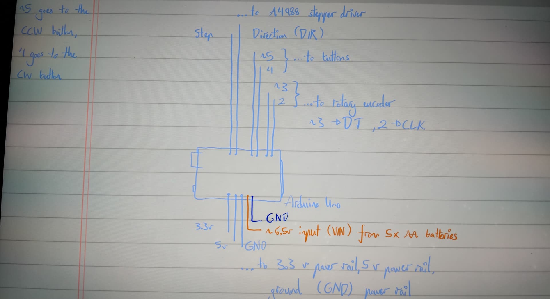

Please post the schematic of your project, even if it is freehand.

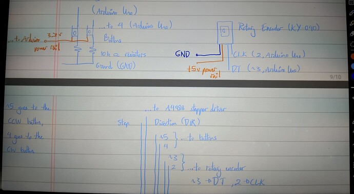

I don't understand how the buttons are connected to the processor.
What processor are you using?
Depending on how the buttons are connected, where you are using:
if (digitalRead(ButtonCW) == HIGH)
I think it should be:
if (digitalRead(ButtonCW) == LOW)
I'm trying to create a vertical conveyor storage system that allows me to store stuff in a way that's more space efficient (like the one from Wall-E). The rotary encoder is therefore useful as it allows me to adapt the speed dependent on the load on the stepper motor as it lifts stuff up on a pulley system. Everything I am doing is based on the work by Curious Scientist, as can be found here - Stepper motor control with buttons and rotary encoder — Curious Scientist . I simply do not use the LCD display, and replace his stepper driver with an economical A4998 I already had lying aound.

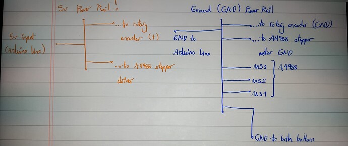

I have tried changing it to this, but pressing the buttons still doesn't cause the stepper motor to move at all. Here are the schematics though

The rotary encoder dictates the speed of the NEMA17 motor and the buttons cause the motor to move either clockwise (CW) or counterclockwise (CCW) when pressed

isn't the button pin HIGH when NOT pressed because you're using the internal pullup resistors?
before dealing with the encoder, suggest getting the buttons and servo to move to predefined positions
