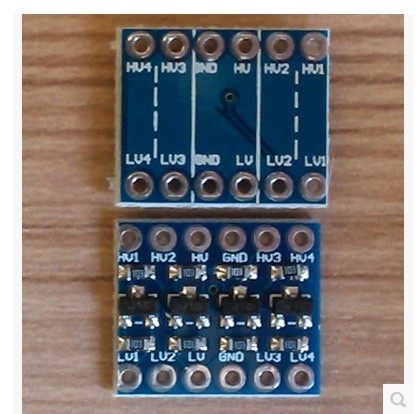

this thing, it was listed as a logic level switcher and I saw another teensy user was using one in a project. It was literally 20cents and I was in a rush to place my order so I just added it and if its useless, no loss.

kelaifu:
Those are meant for level switching for i2c bus devices. I've tried using them for ws2812/neopixels, and they didn't work well for me, any maybe not at all for you. But I did find that 74hc14 worked well (that was Mike's suggestion).

kelaifu:
It is indeed useless for driving WS2812s; that's why I asked as I know it represents a temptation. Keep it for when you are working with I2C systems with different logic levels. :grinning:
