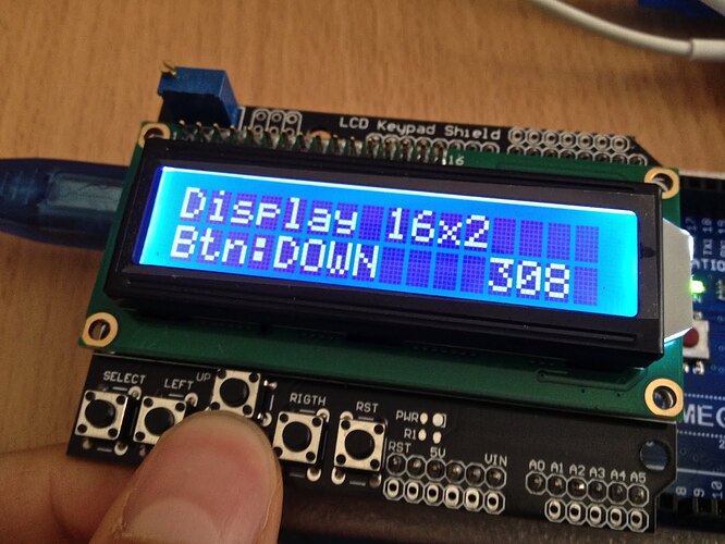

Hello :
I bought Arduino UNO Keypad and LCD Shield.
I tried to see if codes displays messages but does not tell me neither "Hello."
I only listed one line above the LCD .
Codes I have tried and none give me answer. I want to know if the code is broken or the LCD .

Hi.
I have a LCD Keypad shield that looks just like that.
It has the same syntax error (the word "rigth") and solder jumpers on it.
Where did you find instructions to use "LiquidCrystal milcd ( 12, 11 , 5, 4, 3 , 2) ;" for this display ?
I found that this works for mine:
  The circuit:
 * LCD RS pin to digital pin 8
 * LCD Enable pin to digital pin 9
 * LCD D4 pin to digital pin 4
 * LCD D5 pin to digital pin 5
 * LCD D6 pin to digital pin 6
 * LCD D7 pin to digital pin 7
 * LCD BL pin to digital pin 10
 * KEY pin to analog pin 0        (14)  THIS IS THE BUTTON PIN

It is a sketch that tests the keys, and displays what keypresses are detected.
I did change something here, i made it look for a range instead a fixed value for the keypresses.
That will allow some deviation and hopefully get a more reliable read of those keypresses.

Hello.
My keyboard is "DFRobot LCD Keypad Shield". I've been looking online and my mistake was the wrong pin. Ahroa gunciona me very good LCD.
Thank you very much.

I suggest you test the LCD shield using your digital multimeter (you do have one of course) on "diode test" with the red probe to Digital 10 on the shield and the black probe to GND.
If it reads between 0.5 and 1V proving the fault, it is suggested you de-solder the Digital pin 10 on the LCD using a solder sucker (or braid), wiggle it loose and pull it completely out of the plastic header (it will be loose if you have de-soldered it). You will not be able to turn the backlight off, but that really does not matter.
Hmm, glad I peeked at this thread, because I had missed the pin 10 thing. My DFR shield shows ~0.6V on pin 10 with the diode test so I guess I'll need to fix that.
For the record, @OP, I've been using LiquidCrystal lcd(8, 9, 4, 5, 6, 7);
