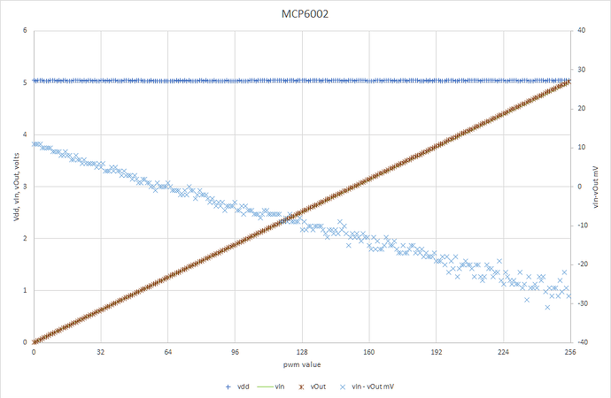

I'm using an ADS1115 to measure the characteristaics of a three terminal device. In this example a 4N35.
This is the circuit
A0 measures Vcc
A1 measures i1 using A0-A1 differential
A2 measures V1
A3 measures V2 and A0 - A3 measures i2
I cant use differential mode because it only works on A0-A1 or A2-A3.
Annoyingly, I'm seeing a lot of noise on the reading for i2 - which I believe is indicative of noise on the GND-Vcc supply; but I've put an RC filter on with little if any improvement.
I've considered the layout; Vdd, A0, C2+ R5 and R6 are all on the same track.
The noise on the i2 measurement is still present if T2 of the DUT is disconnected.
Example data: the 0.019mV on iDUT is 1 lsb so ignore. The 0.356mV on iT3 is 19 lsb.
nOut vDUT iDUT iT3 vT3
0 22.7 0 0 5031.7
2 22.7 0 0 5030.1
4 36.4 0 0.356 5027.2
6 55.5 0 0 5027.2
8 75 0 0 5028
10 95.1 0.019 0 5029.7
12 114.9 0.019 0.356 5025.6
14 135.2 0 0 5026.5
16 155.6 0 0 5027.1
18 175.9 0 0.056 5027.2
20 196.1 0 0 5029.5
22 216.4 0.019 0.056 5028.7
24 236.4 0 0.038 5026.1

Did not read all of it, but are you aware that the mcp6002 is not fully rail2rail.
U1B is measuring high-side, but is that 10 ohm sense resistor, at least 0.3volt below VCC of the opamp.
Leo..
Thanks Leo; yes im sure true "rail-rail" at the output is a bit much to expect. However the only load on the output is the 100k feedback resistor and the input impedance of the ads1115.
On test I see a range of 0.000V at the output to + Vdd - 18mV
and as far as I have measured the input tuly is "rail-rail".
what I really found interesting is the instability of the usb voltage - even on a PC with a very good psu.
I was talking about the common mode range of the inputs.
Leo..
I couldnt believe this Leo, it says the cmrr exceeds the supply voltages by 300mV; so I tested it
a little bit of input offset and a gain error but no non-linearity near the rails!
gain error; Acl = Aol / 1+Aol and for this op amp Aol is typically around 100dB = 1 * 10^5
the expected max error could be Vdd * 1/1 * 10^5 = 50uV - doesnt explain it.
Ahh, read that wrong.
Thought that it had to be 0.3volt inside the supply boundaries.
Leo..
The gain error is a measurement error on the ADS1115 - beware it has a significant channel mismatch and gain error
